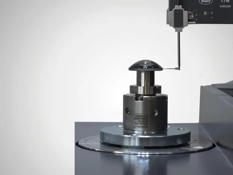

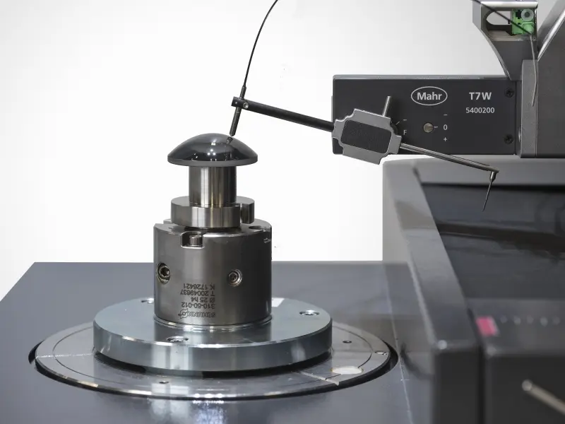

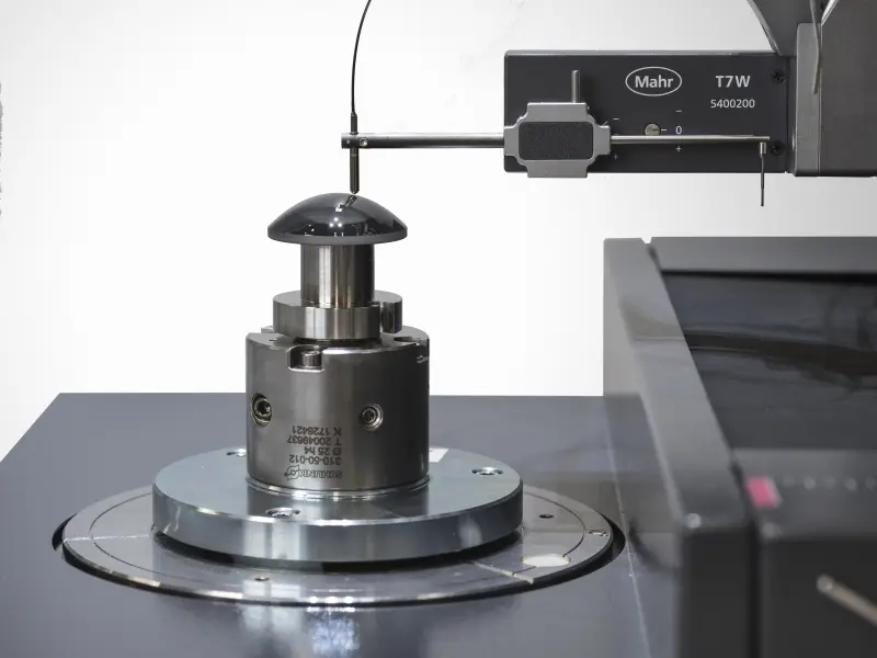

The optical surface is measured without contact using the IPS 15 optical sensor. The edge and the back of the optical element can be measured with a tactile probe. Both systems (optical and tactile) are combined in one probe arm unit on the probe system of the MarForm MFU 200 Aspheric 3D measuring system. A wide selection of stylus arms allows for further combinations of different styli in one stylus unit. This makes it possible to measure all sides of an optical element (e.g., an aspheric) in one clamping and using the automatic switching between the optical and tactile tracing elements.
This measuring method has the advantage that the polished optical surface does not undergo mechanical tracing, but is measured only optically and thus without contact. The slightly rough lens edge is detected quickly and accurately with the tactile probe.

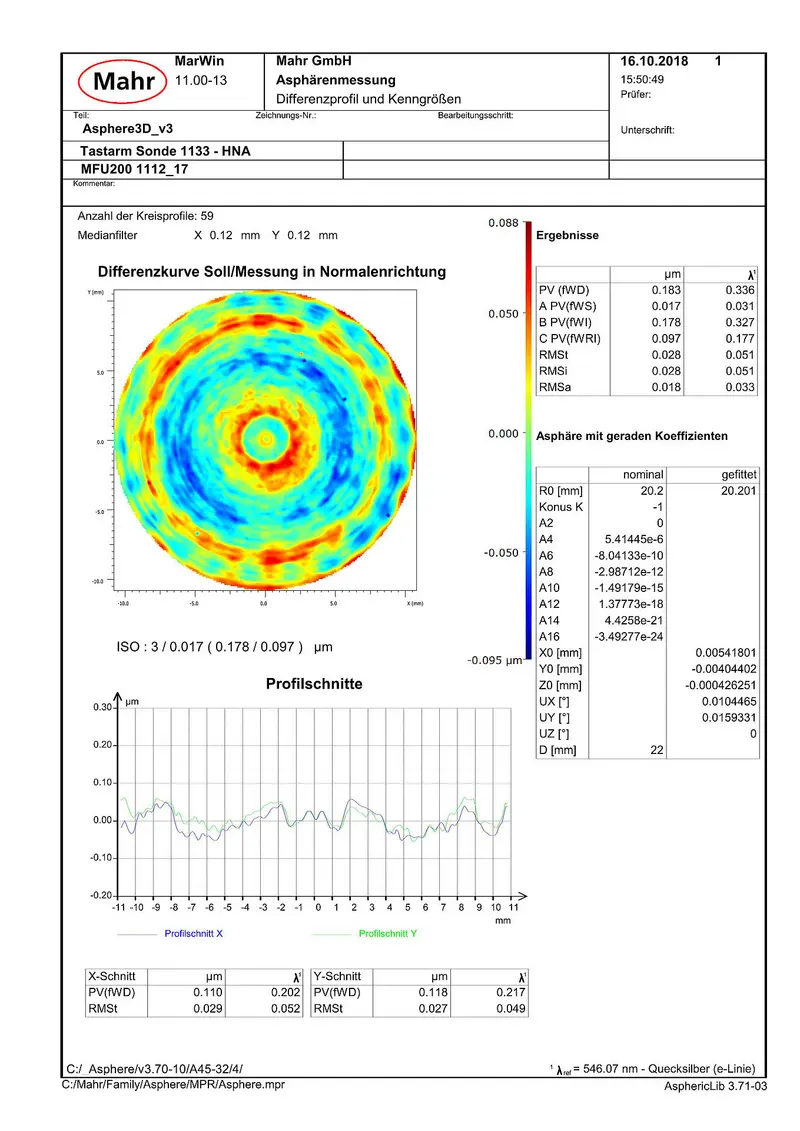

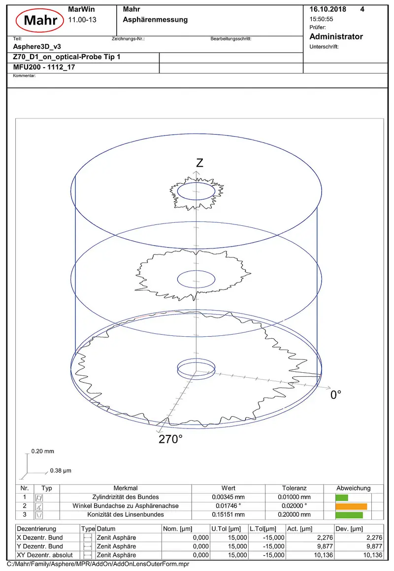

Depending on the design of the optical element, various features and relevant dimensions can be determined:

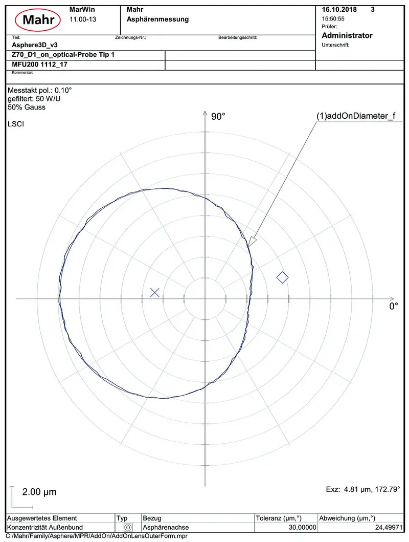

- Single surface centration error of the edge geometry to the optical axis
- Angle and angular position of the edge geometry to the optical axis

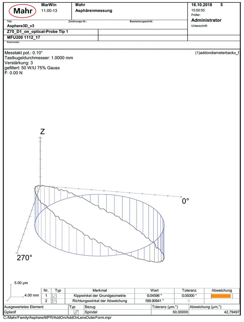

- Tilt angle and angular position of the backside to the optical axis
The technology used by Mahr also detects non-systematic deviations which, for example, arise due to external influences or the movement of the machine itself. The measuring system is always aware of exactly where the probe element is located. In combination with a highly dynamic digital control, this also benefits the positioning accuracy of the system. Thus, an extremely high reproducibility can be achieved even under changing conditions.
