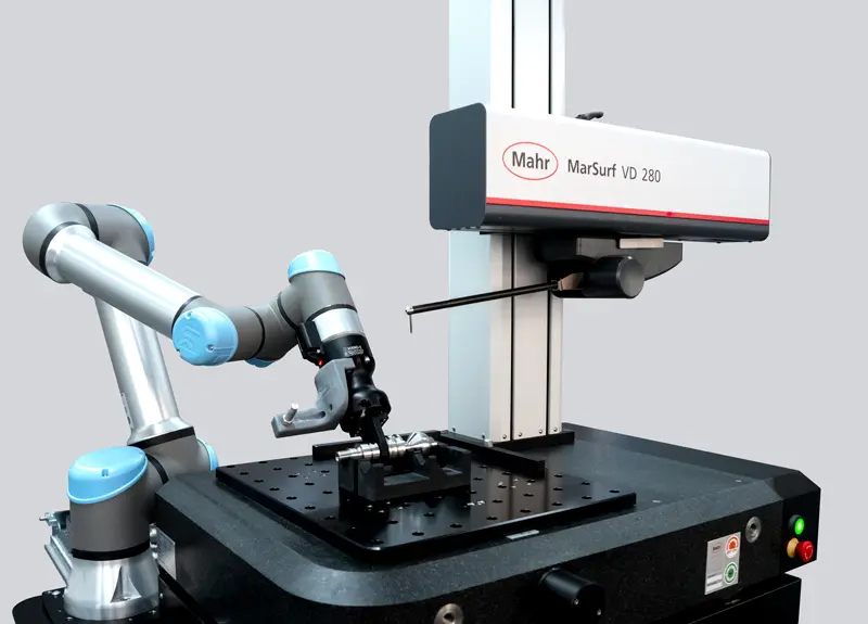

Mahr will show the new development for the first time at Control 2023 on a MarSurf contour and roughness measuring station. This is particularly suitable for customers who want to inspect high quantities of a recurring workpiece as continuously and promptly as possible.
Robot automatically removes workpieces
The system consists of a workpiece storage unit with pull-out magazines containing the parts to be measured. The MarSurf measuring station is located on the workpiece storage unit; a robot arm is attached to the side so that it can easily access the magazines. The robot pulls one out and removes a component using the gripper, which was made to fit precisely in 3D printing. It then places it on the workpiece holder of the MarSurf device, and the measurement is started automatically. After successful measurement, the robot puts the part back into the workpiece storage.
