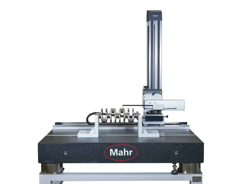

This measuring station has been designed for contour measurement – and optionally also roughness measurement – on large turned parts or crankshafts.
The workpiece is loaded and positioned manually. Then the measuring point is approached by manually moving the measuring column parallel to the workpiece axis.
The integrated Hy-axis at right angles to the workpiece axis is used for fine adjustment of the zenith search.
Manual crankshaft measuring station
This measuring station is designed for measurements of large crankshafts or general rotationally symmetrical components up to a length of approx. 1600mm.Larger lengths are available on request. The workpiece can be placed on V-blocks on the measuring station using a crane as the positioning tool.
The optionally available digital positioning display can be used for exact positioning.
The Zenith search on rotationally symmetrical components is completed using the y-axis and the relevant fine adjustment.
Measurement of different workpieces with a length of up to 1600 possible on one measuring station
Sophisticated operating concept even for heavy workpieces
Thanks to individual configurations, various measuring tasks can be completed with one measuring station.
