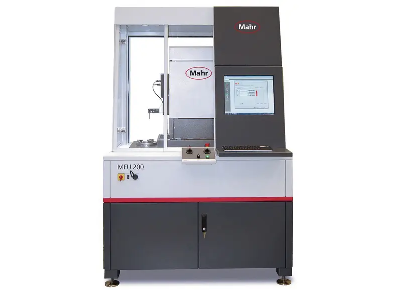

MarForm MarForm MFU 200
Art. no. 5440580
High precision, fully automatic reference form measuring device
The MarForm MFU 200 let's you measure high-precision components quickly and close to production. MarForm measuring devices have been known for decades for their accuracy and stability.
- Optimization for use in the measuring room and the achievement of reference quality
- High reproducibility of measurement results through dynamic real-time compensation
- Productivity thanks to high temperature stability (no calibration required once or several times a day)
- Can be expanded with optical IPS point sensor for combined, optical-tactile use
- User-friendly operation and fast results

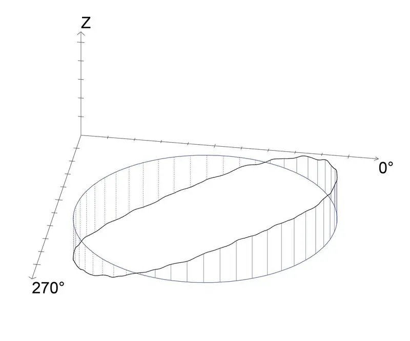

| Axial running deviation C-axis | 0.02 + 0.0002 µm/mm*measuring radius (acc. to DIN EN ISO 1101) |
| Straightness deviation X-axis | 0.075 μm/measuring path (according to DIN EN ISO 1101) |
| Straightness deviation Z-axis | 0.1 μm/measuring path (according to DIN EN ISO 1101) |

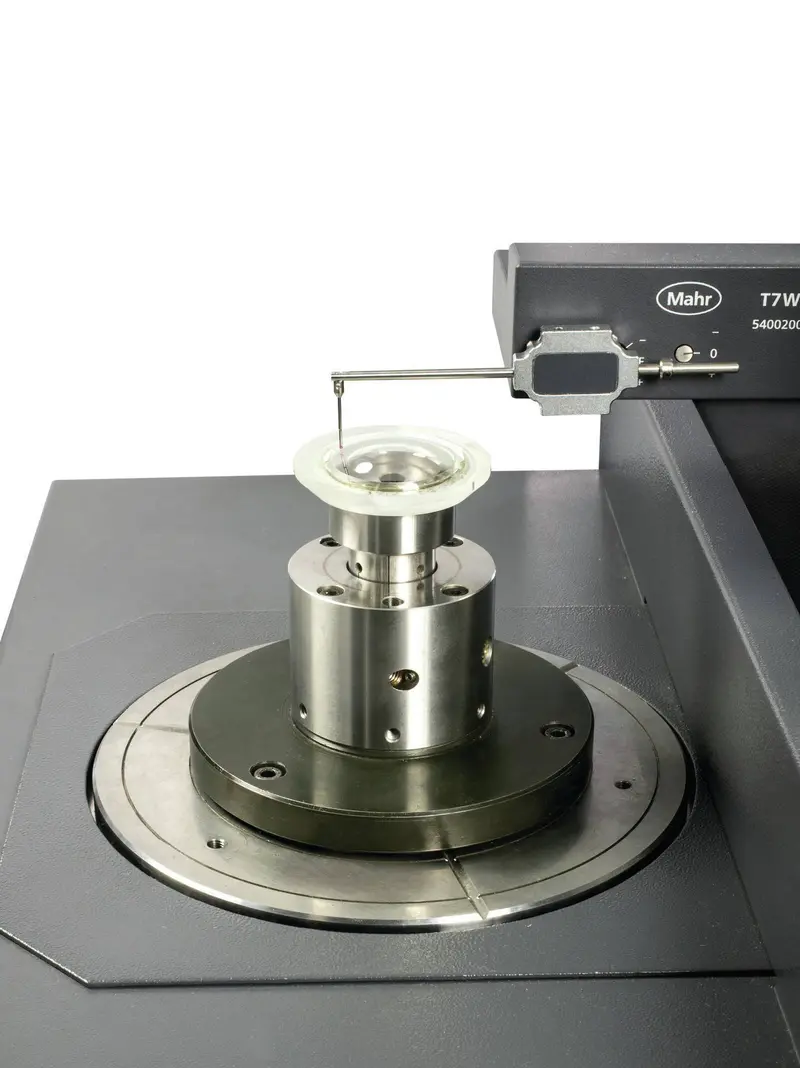

| Probe system | Tactile 1D |

Complete an optical and tactile measurement of your lenses and make use of all of the advantages of the highly accurate form tester.
Output of the characteristic values as per DIN ISO 10110-5, for example PV, RMS, and lead error
