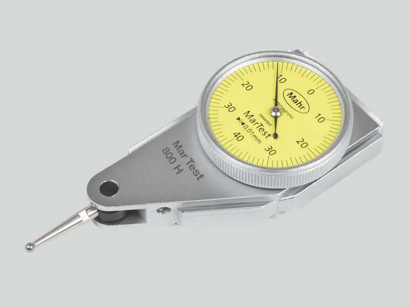

MarTest 800 H
Art. no. 4303200
Test indicator MarTest 800 H
DIN 2270
Measuring range mm: ± 0.4 mm
Graduation value mm: 0.01
Package contains: spanner for changing the styli, stylus dia. ø 2 mm, mounting shaft 800a8, test certificate, instruction manual, case
- High contrast dial face, sealed with an O-Ring
- against scratching or damage caused by hot shavings
- optimal resistance to solvents - Matt chrome-plated protective casing with three integrated dovetail guide rails
- Anti-magnetic model
- Ball-bearing mounted double lever
- Overload protection thanks to friction clutch
| Product type | 800 H |
| Measuring range mm | ± 0.4 |
| Range per rev. in mm | 0.8 mm |
| Graduation value mm | 0.01 |
| Span of error fe (µm) | 10 µm |
| Total span of error fges (µm) | 13 µm |
| Partial measuring range ft (µm) | 5 µm |
| Measuring value hysteresis fu (µm) | 3 µm |
| Repeatability fw (µm) | 3 µm |
| Measuring force | 0.25 N |
| Figur on dial face | 40-0-40 |
| Dial color | Yellow |
| Scale diameter | 27.5 mm |
| Dimensions | a 30 mm | |
