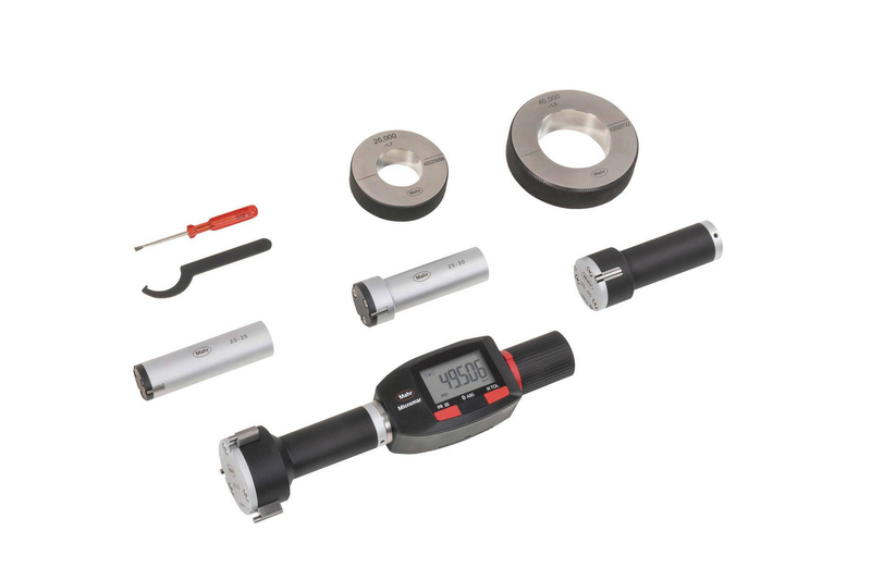

Micromar 44 EWRi
Art. no. 4191342
Digital 3-point inside micrometer - in Set Micromar 44 EWRi
For measuring of:
- Through holes
- Blind holes
IP protection category: IP 65
DIN 863-4
Measuring range 20 - 50 mm mm
Package contains: Basic unit 44 EWRi-g, measuring heads 44 Ak, setting rings, battery, instruction manual, case
| Micromar 44 EWRi | Art. no. 4191342 | |
| Measuring range | 20 - 50 mm |
| Measuring range | .775 - 2" |
| Resolution mm/inch | 0.001 / .00005" |
| Error limit µm | 4 µm |
| Notes error limit | over the full length of the anvils |
| Battery type | CR 2450N (3V Lithium) |
| Spindle thread pitch_mm | 1.5 mm |
- Through holes
- Blind holes
| Label | Art. no. | Measuring range | Measuring range | Resolution mm/inch | Battery type | |
Wireless receiver for measuring instruments with integrated wireless i-Stick |
4102220 | ||||
Clamping plate for 44 EWR(i) / 844 EWR(i) 44 EWR-gs |
4190400 | - | |||
Digital inside micrometer - Basic unit 44 EWRi-g |
4191361 | 20 - 100 mm | .775 - 4.0" | 0.001 / .00005" | CR 2450N (3V Lithium) |
