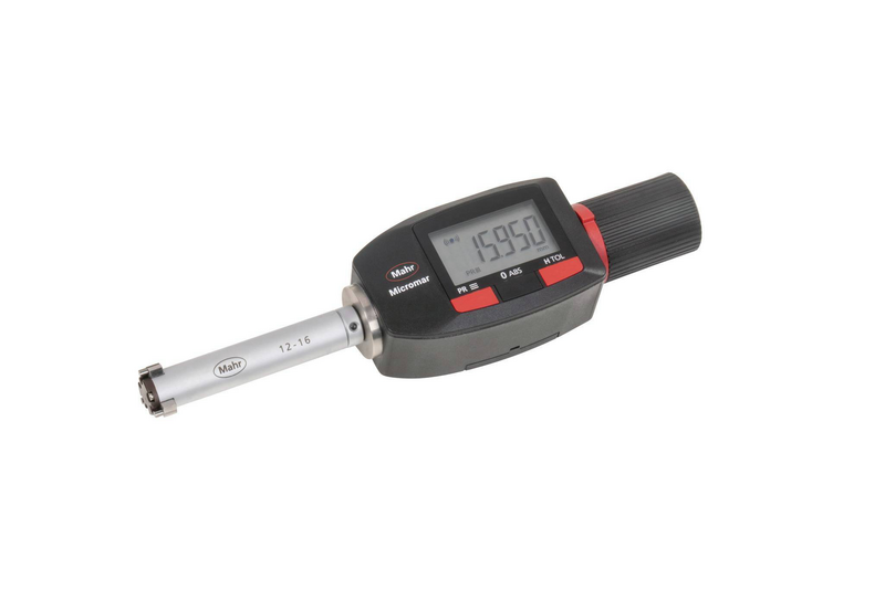

Micromar 44 EWRi
Art. no. 4191311
Digital 3-point inside micrometer Micromar 44 EWRi
For measuring of:
- Through holes
- Blind holes
IP protection category: IP 65
DIN 863-4
Measuring range mm 25 - 30 mm mm
Package contains: Basic unit 44 EWRi-g, measuring head 44 Ak, instruction manual, battery, case
Micromar 44 EWRi | Art. no. 4191311 | |
Measuring range mm | 25 - 30 mm |
Measuring range | 1 - 1.2" |
Resolution mm/inch | 0.001 / .00005" |
Error limit µm | 4 µm |
Notes error limit | over the full length of the anvils |
Battery type | CR 2450N (3V Lithium) |
Spindle thread pitch_mm | 1.5 mm |
Dimensions | b 9 mm | c 4 mm | d 68 mm | |
- Through holes
- Blind holes
Label | Art. no. | Diameter in mm | Standard | |
Setting ring 355 E |
4710045 | 25 mm | DIN 2250 C |
