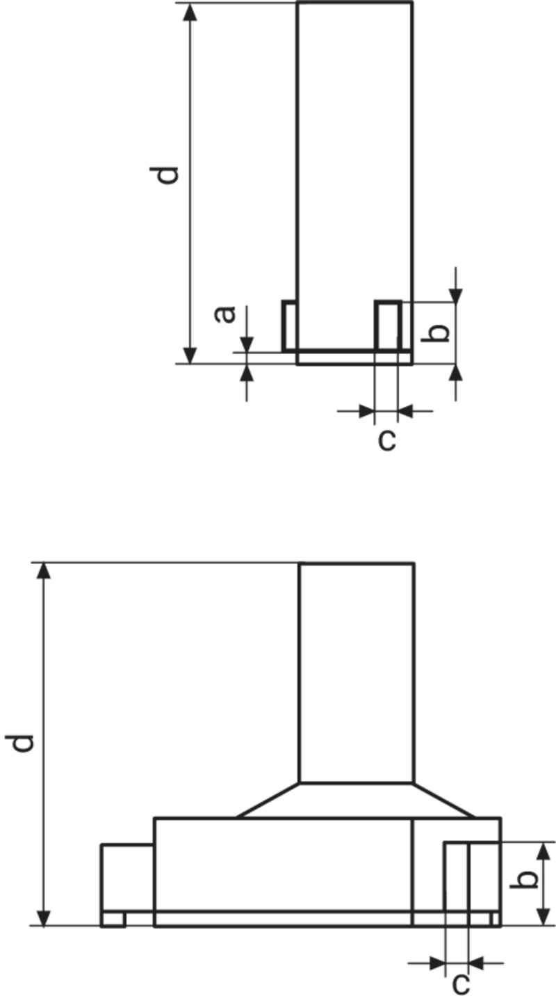

Measuring range mm 50 - 60 mm mm
Package contains: basic units 44 EWg, measuring head 44 Ak, instruction manual, battery, case
- Threaded connection for changing the measuring head
- Self-centering measuring head consists of 3 anvils (offset 3 x 120°)
- Measuring anvils from 12 mm are carbide tipped
- From 12 mm measuring anvils for measurements up to the bottom of the bore
- From 40 mm measuring head housing made of anodized aluminium
Micromar 44 EWR | Art. no. 4191130 | |
Measuring range mm | 50 - 60 mm |
Measuring range | 2 - 2.35" |
Resolution mm/inch | 0.001 / .00005" |
Error limit µm | 5 µm |
Notes error limit | over the full length of the anvils |
Battery type | CR 2032 (3V Lithium) |
Dimensions | b 18 mm | c 5 mm | d 79 mm | |
