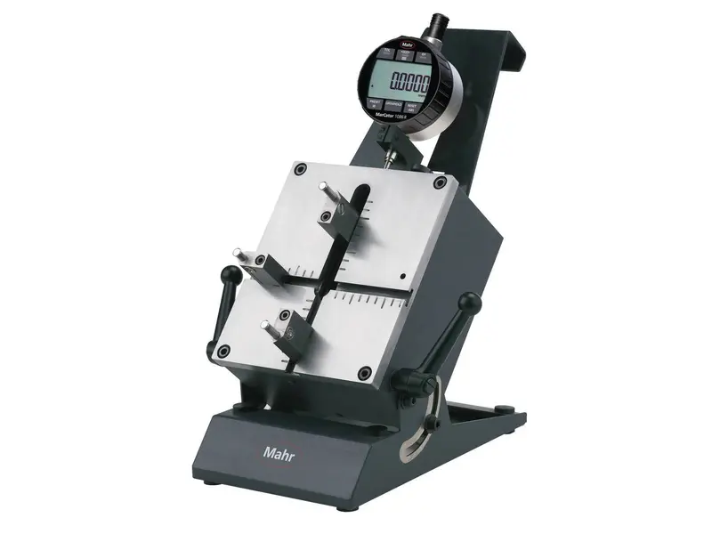

Multimar M36B-10
Art. no. 2003200
- Friction-free, zero-backlash measuring anvil holder for high measuring accuracy
- Parallel spring-loaded system for repeatable measuring force
- User-friendly and ergonomic:
- Table surface can be tilted and clamped between 0° and 90°
- Adjustable lifting of movable measuring probe - Adjustable measuring force
| Multimar M36B-10 | Art. no. 2003200 | |
| Application range, outside | 6.5 - 125 |
| Application range, inside | 20 - 130 |
| Measuring force from | 0 N |
| Measuring force up to | 35 N |
- For measuring inside and outside dimensions: diameters, lengths, distances between bores, offsets, etc.
- Measurement in bores, outside surfaces, recesses, centering shoulders, etc.
- Determination of roundness deviations by turning the part (with 3-point set-up)
- T-slots arranged in a T-shape for comparative 2-point measurements or self-centering 3-point measurements
- Measuring setup: 1 movable and 1 or 2 fixed measuring anvils with probe
