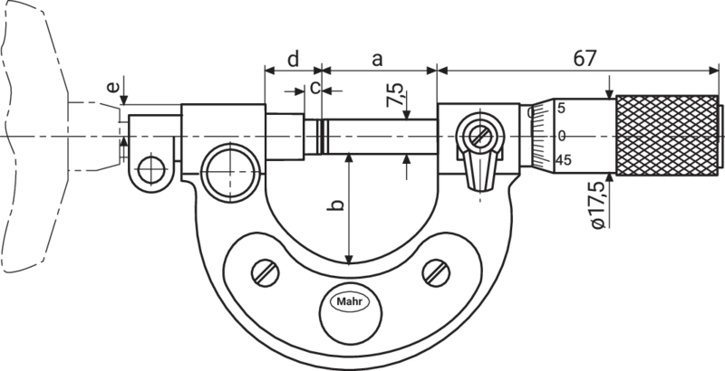

| Micromar 40 T | Art. no. 4154004 | |
| Measuring range mm | 150 - 200 |
| Graduation value µm | 1 µm |
| Error limit µm | 2 µm |
| Parallel error in µm | 2 µm |
| Flatness in µm | 0.2 µm |
| Error limit Ge (µm) | 1 µm |
| Measuring force | 7.5 N |
| Spindle thread pitch_mm | 0.5 mm |
| Dimensions | a 177 mm | b 112 mm | c 5.5 mm | d 30 mm | e 8 mm | |
