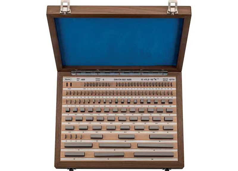

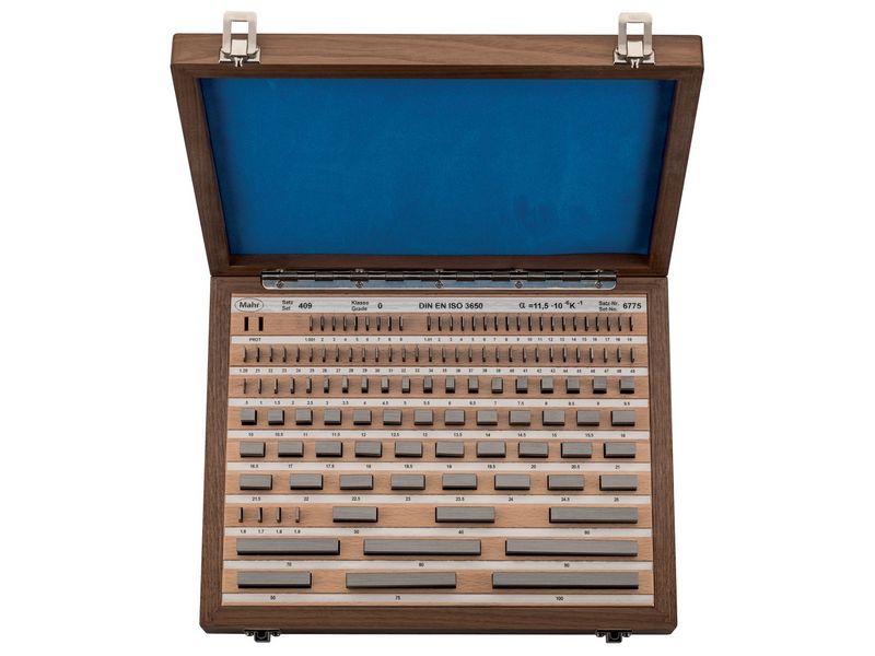

The accuracy of a gage can only be known by reference to a higher standard.  Thus, gages are set to masters that are more accurate than the gage.  These masters are certified against gage blocks produced to a higher standard of accuracy, ultimately traceable to nationally or internationally recognized "absolute" standards that define the size of the dimensional unit.  This is the line of traceability, which must be followed for calibration to be valid.
Calibration is used to determine how closely a gage adheres to the standard.  When applied to a master ring, disc, or a gage block, it reveals the difference between the nominal and the actual sizes.  When applied to a measuring instrument such as a comparator, calibration reveals the relationship between gage input and output, in other words, the difference between the actual size of the part and what the gage says it is.

The conditions under which calibration occurs should duplicate the conditions under which the gage is used.  Calibration in a high-tech gaging lab may be misleading if the gage normally lives next to a blast furnace.  Similarly, a snap gage that is normally used to measure round parts should be calibrated against a master disc or ring, and not with a gage block.  The gage block could produce misleading results by bridging across worn areas on gage contacts, while a round master would duplicate the actual gaging conditions and produce reliable results.
