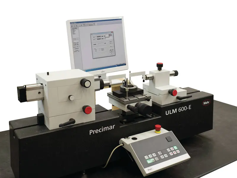

Precimar ULM 1000-E
Art. no. 5350262
Calibration measuring instruments ULM 1000-E
Measuring range for outer measurement [mm] 0 to 1060
Measuring range for inner measurement [mm]
X-axis measuring system:
Heidenhain incremental, precision length measuring system, 100 mm long
Z-axis measuring system:
RENISHAW incremental, precision length measuring system, 80 mm long
| Precimar ULM 1000-E | Art. no. 5350262 | |
| Measuring range for outer measurement [mm] | 0 to 1060 |
| Measuring range for inner measurement [mm] | 0.5 to 905 |
| Direct measuring range [mm] | 100 |
| Measuring uncertainty MPEE1 (L in mm) [µm] | ≤ (0.09+L/2000) |
| Repeatability [µm] | ≤ 0.05 |
| Measuring forces [N] | 0.2 ; 1.0 to 4.5 ; 11 |
| Device length [mm] | 1500 |
| Mass [kg] | 215 |
| Device dimensions |
1080 / 1500 / 2000 x 380 x 480 ULM 300-E: 685 x 280 x 480 |
