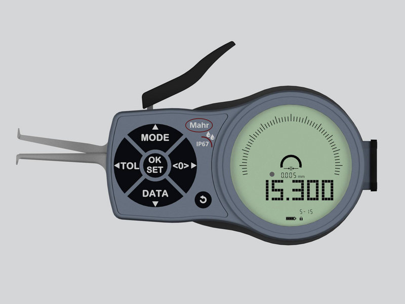

Marameter 838 EI
Art. no. 4495460
Digital inside quick probe Marameter 838 EI
Measuring range: 5 - 15 mm
Graduation value mm:
Measuring depth mm: 35
Package contains: instruction manual, battery, test certificate
- High contrast, analog LCD segment display
- Tolerance display via 2 LEDs
| Product type | 838 EI |
| Measuring range | 5 - 15 mm |
| Error limit (mm) | 0.015 mm |
| Repeatability mm | 0.005 mm |
| Measuring force (N) | 0.8 - 1.2 |
| Measuring contact ball diameter mm | 0.6 mm |
| Groove width | 0.8 mm |
| Groove depth | 2.3 mm |
| Length of moving measuring contact | 2.5 mm |
| Length of fixed measuring contact | 2.5 mm |
| Measuring depth mm | 35 mm |
- Specified measuring programs according to application
- Absolute/relative measuring program
