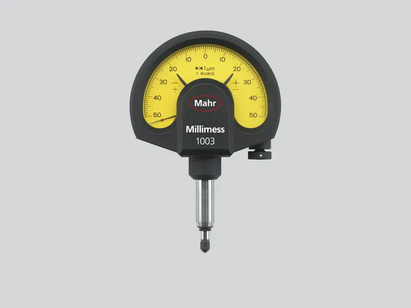

Millimess 1003
Art. no. 4334070
Mechanical dial comparator Millimess 1003
DIN 879-1
Dial color: Yellow
Measuring range mm: ± 50 µm
Graduation value µm: 1 µm
Measuring force: 0.4 N
Package contains: test certificate, case
- Large, high contrast dial face
- Lockable fine adjustment screw
- Shockproof movement
- Measuring spindle is mounted in a high precision ball guide for minimal hysteresis
- Resistant to lateral forces (side play) acting on the measuring spindle
- Maximum sensitivity and accuracy are ensured by the jeweled movement in conjunction with the precision gears and pinions
- Box type protective housing
- Constant measuring force
- Measuring spindle can be retracted with either a screw in cable release or with a lifting knob
| Product type | 1003 |
| Measuring range mm | ± 0.05 |
| Graduation value µm | 1 µm |
| Error limit Ge (µm) | 1 µm |
| Error limit Gges (µm) | 1.2 µm |
| Error limit Gt (µm) | 0.7 µm |
| Measuring value hysteresis fu (µm) | 0.5 µm |
| Repeatability fw (µm) | 0.5 µm |
| Measuring force | 0.4 N |
| Figure on dial face | 50-0-50 |
| Dial color | Yellow |
| Scale diameter | 50 mm |
- Models with reduced / increased measuring force
- for measurements on thin walled, soft materials or delicate surfaces
