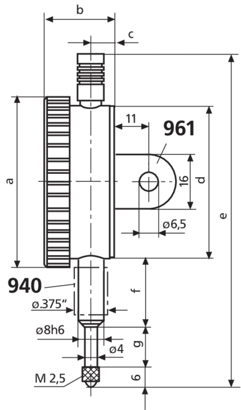

| Product type | 810 S |
| Measuring span in mm | 10 mm |
| Range per rev. in mm | 1 mm |
| Graduation value mm | 0.01 |
| Error limit measuring range µm | 15 µm |
| Error limit 1 revolution µm | 10 µm |
| Error limit 1/2 revolution µm | 9 µm |
| Error limit 1/10 revolution µm | 5 µm |
| Measuring value hysteresis fu (µm) | 3 µm |
| Repeatability fw (µm) | 3 µm |
| Figure on dial face | 0 - 100 |
| Dial color | White |
| Scale diameter | 50 mm |
| Dimensions | a 58 mm | b 23 mm | c 7.5 mm | d 52 mm | e 112 mm | f 21 mm | g 16 mm |
