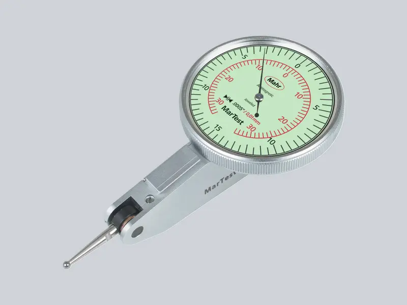

MarTest 801 SGI
Art. no. 4307970
Test indicator MarTest 801 SGI
Factory standard
Measuring range mm: ± .015"
Graduation value inches: .0005"
Package contains: spanner for changing the styli, stylus dia. ø 2 mm, mounting shaft 800a3/8, test certificate, instruction manual, case
- High contrast dial face, sealed with an O-Ring
- against scratching or damage caused by hot shavings
- optimal resistance to solvents - Matt chrome-plated protective casing with three integrated dovetail guide rails
- Anti-magnetic model
- Ball-bearing mounted double lever
- Overload protection thanks to friction clutch
| Product type | 801 SGI |
| Measuring range mm | ± 0.3 |
| Measuring range inches | ± .015" |
| Range per rev. in mm | 0.6 mm |
| Pointer rotation (inches) | .03" |
| Graduation value mm | 0.01 |
| Deviation range fe (inches) | .0004" |
| Total deviation range fges (inches) | .0005" |
| Partial measuring range ft (inches) | .0002" |
| Measuring value hysteresis fu (inches) | .00012" |
| Repeatability fw (inches) | .0001" |
| Measuring force | 0.15 N |
| Figure on dial face | 15-0-15 |
| Dial color | Green |
| Scale diameter (inches) | 1.5" |
| Dimensions | a 40.5 mm | c 13.6 mm | d 17.8 mm | e 75 mm | f 99 mm |
