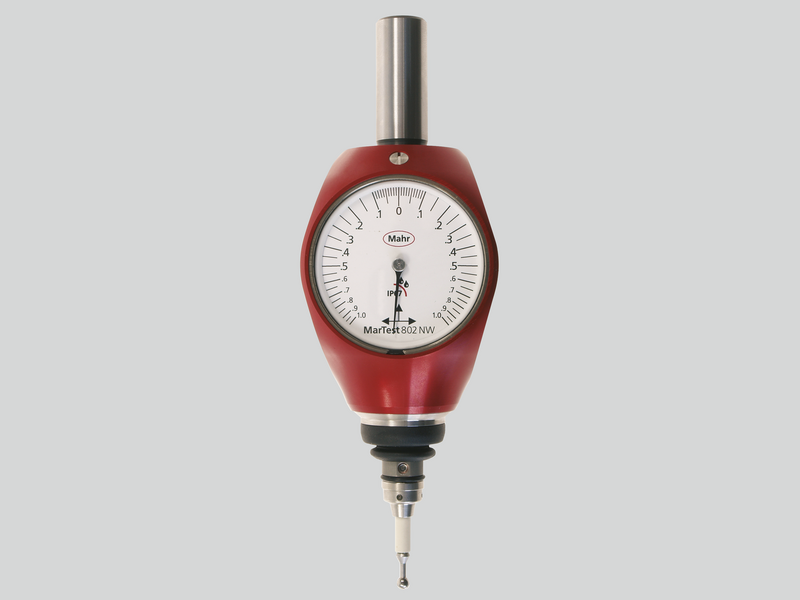

Mechanical 3D touch probe MarTest 802 NW
Working areas, X-, Y-, Z-axis: 6,6 mm
Graduation value mm: 0.01
Package contains: battery, instruction manual, stylus 802 EWt
- Large, high contrast dial face
- Can be controlled independently of a machine tool
- Large working range in all axes (X, Y, Z) prevents damage to the stylus by contacting errors
- Compact metal housing and long probe arm
- High accuracy and linearity
- Shockproof and waterproof, ideal for the use on a machine with a tool changer
| Product type | 802 NW |
| Display ranges | +/-1mm |
| Working areas, X-, Y-, Z-axis | 6,6 mm |
| Graduation value mm | 0.01 |
| Repeatability at zero point, unidirectional | ± 0,01mm |
- determine the zero position on workpieces
- determine the center of bores
- determine and correct the alignment of a workpiece
and for the measurement with defined measuring force (by moving the machine tool axes in X/Y and Z) of
- lengths
- widths
- distances
- depths
