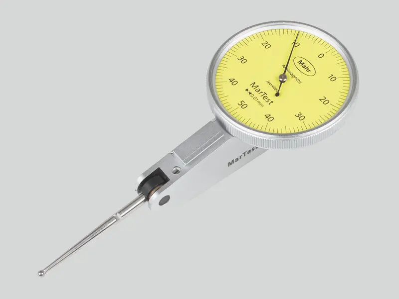

MarTest 800 SGB
Art. no. 4301300
Test indicator MarTest 800 SGB
Factory standard
Measuring range mm: ± 0.5 mm
Graduation value mm: 0.01
Package contains: spanner for changing the styli, stylus dia. ø 2 mm, mounting shaft 800a6 (800 SA/SGA/SGB), mounting shaft 800a8, test certificate, instruction manual, case
- High contrast dial face, sealed with an O-Ring
- against scratching or damage caused by hot shavings
- optimal resistance to solvents - Matt chrome-plated protective casing with three integrated dovetail guide rails
- Anti-magnetic model
- Ball-bearing mounted double lever
- Overload protection thanks to friction clutch
| Product type | 800 SGB |
| Measuring range mm | ± 0.5 |
| Range per rev. in mm | 1 mm |
| Graduation value mm | 0.01 |
| Span of error fe (µm) | 10 µm |
| Total span of error fges (µm) | 13 µm |
| Partial measuring range ft (µm) | 5 µm |
| Measuring value hysteresis fu (µm) | 4 µm |
| Repeatability fw (µm) | 3 µm |
| Measuring force | 0.07 N |
| Figur on dial face | 50-0-50 |
| Dial color | Yellow |
| Scale diameter | 38 mm |
| Dimensions | a 40.5 mm | c 31.4 mm | d 35.7 mm | e 93 mm | f 117 mm |
