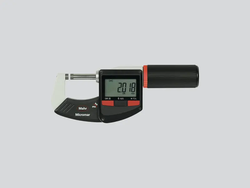

Micromar 40 EWRi-L
Art. no. 4157121
Digital Micrometer Micromar 40 EWRi-L
- Avoiding workpiece damage: The non-rotating spindle has a touching touch, which prevents scratch marks on sensitive and finely machined surfaces
- Ideal for measuring thin metal foils without twisting and bending them
- Thread flank measurement by using thread wires: Both wire holders always remain in the engaged position with the non-rotating spindle
IP protection category: IP 65
ISO 3611
Measuring range mm 25 - 50 mm mm
Package contains: setting standard (measuring range of 25-50 mm), battery, test certificate, instruction manual, case
- High contrast digit display
- QUICK DRIVE
- Sliding spindle
| Micromar 40 EWRi-L | Art. no. 4157121 | |
| Measuring range mm | 25 - 50 mm |
| Measuring range | 1 - 2" |
| Resolution mm/inch | 0.001 / .00005" |
| Error limit µm | 2 µm |
| Parallel error in µm | 2 µm |
| Flatness in µm | 0.6 µm |
| Measuring force (N) | 5 - 10 |
| Material Contact surface | carbide |
| Spindle diameter | 6.5 mm |
| Spindle thread pitch_mm | 5 mm |
| Dimensions | a 36 mm | b 11 mm | c 57 mm | |
