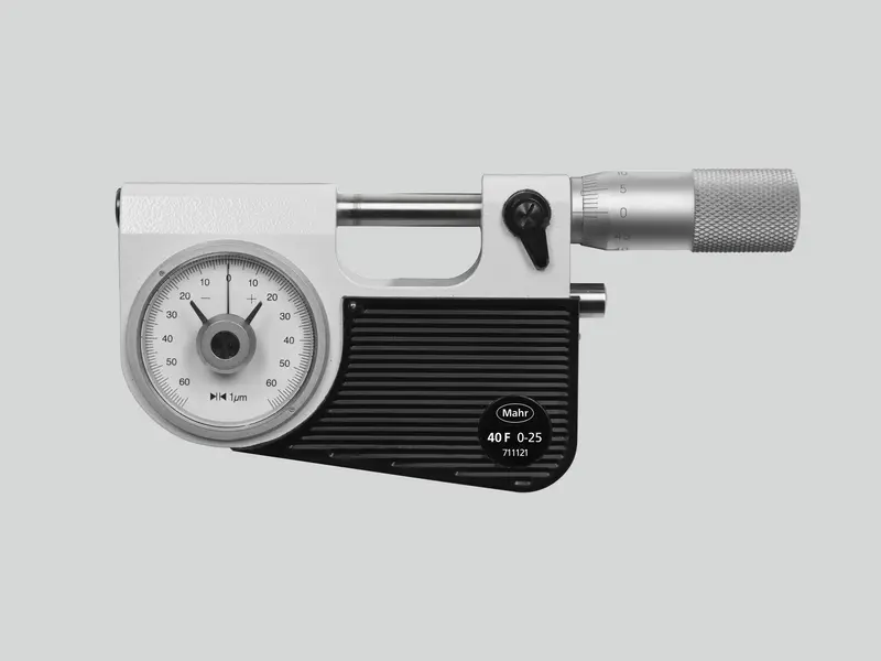

Micrometer with integrated dial comparator Micromar 40 F
Factory standard
Measuring range mm: 25 - 50 mm
Graduation value µm: 1 µm
Package contains: instruction manual, case
- Dial comparator is integrated in frame
- Chrome plated steel frame, heat insulated
- Retraction of the movable anvil ensures maximum wear resistance
- Locking device
- Constant measuring force

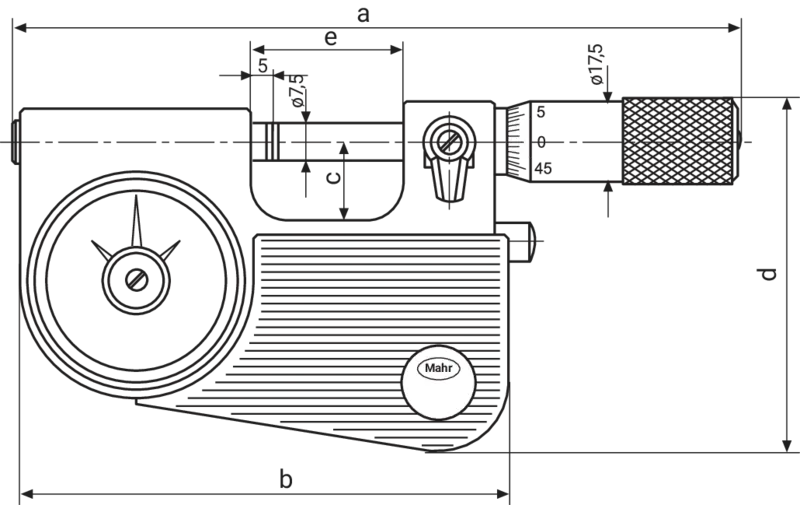

| Dimensions | a 174 mm | b 125 mm | c 30 mm | d 85 mm | e 56 mm | |
