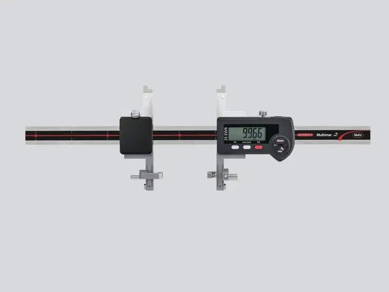

Multimar 25 EWR
Art. no. 4119002
Digital universal calipers Multimar 25 EWR
Application range, outside: 0 - 1000
Resolution mm/inch: 0,01 / .0005"
Data interface: USB, Digimatic, Opto RS-232C, wireless
IP protection category: IP 65
Package contains: battery, instruction manual, mounting and resting blocks, wooden case, without arms/attachments and anvils
- Interchangeable measuring arms, anvils and stop elements (optional accessories) for easy adaptation to individual measuring tasks
- Due to the patented mounting fixture of the measuring elements provided on the upper and lower longitudinal face of the arm holders, the digital display is always in the operator's line of vision
- The application range can be extended by turning the measuring arms
- The two arm holders can be moved along the rail, providing a well-balanced weight distribution even with small dimensions
- Slide and rail are made of hardened stainless steel

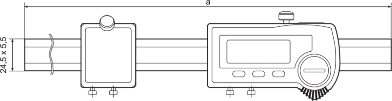

| Multimar 25 EWR | Art. no. 4119002 | |
| Application range, outside | 0 - 1000 |
| Error limit (mm) | 0.04 mm |
| Dimensions | a 1200 mm | |
