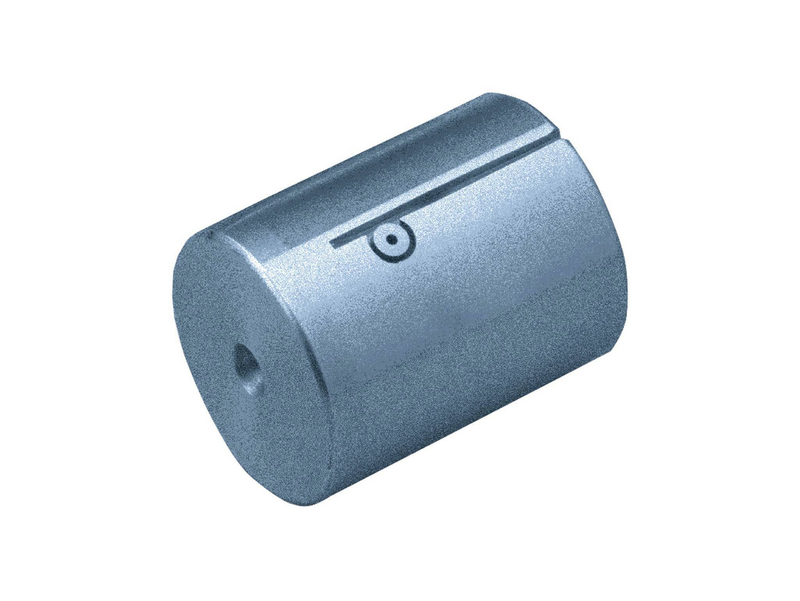

Millimar DP20
DP50
DP60
Art. no. 2115005PVD
Nozzle through-hole pin Millimar DP20
DP50
DP60
Compatibility: Federal
Material type: PVD coated based on AlCrN
Magnification: 5000:1, 2500:1, 1260:1
Nominal size mm: 40.000 - 60.000 mm
Nominal size in inches: 1.575-2.362"
- Mahr / Mahr Federal nozzle plug gages have a large clearance tolerance, making them easier to insert into the bore to be measured and allowing a greater measuring range
- Long service life: Thanks to a larger plug gage spacing and (optional) PVD coating of the pin body, the nozzle plug gage has an extended service life
- The recessed measuring nozzles are located deep in the body of the plug gage, protecting them from damage
- Large nozzle dimensions prevent clogging with dirt and oil
- Other lengths for the pin body (L2) and position of the measuring nozzles (b) are available on request
- Request and order information:
When making a request or submitting an order, please always include the following:
Transmission ratio of the display unit (e.g. DP50 / 2500:1),
the nominal size to be measured,
the specified workpiece tolerance
and whether the pin body should include a PVD coating or not.
