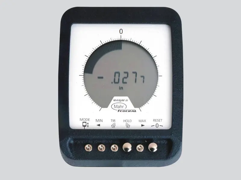

Millimess Maxµm III
Art. no. 2033001
Display unit Millimess Maxµm III
IP protection category: IP 54
Data interface: none
Data output Maxµm: without data ouput
Factory standard
Measuring span in mm: Dependent on probe type
Package contains: interchangeable dials, battery, instruction manual
- Large, high contrast numerical and scale display with unique display of the boxes to improve the visual perception of roundness and flatness tests and during reversing point searches for bore measurements
- Replaceable dial plates
- Inductive absolute measuring system
- Metal housing with robust operating keys
| Product type | Maxµm III |
| Measuring range mm | Dependent on probe type |
| Battery type | CR 123A (3V Lithium) |
