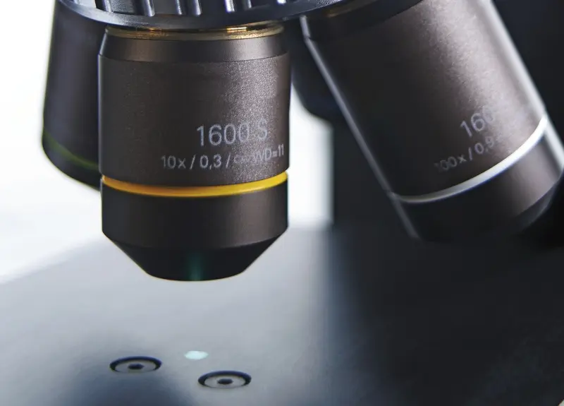

Measuring systems for optical, three-dimensional scanning are now increasingly used in surface analysis. These systems enable an areal analysis of the surface – on the basis of DIN EN ISO 25178. Such an areal evaluation provides characteristic values that cannot be determined by means of the stylus method (or only with considerable time expenditure). Depending on the application, an evaluation of the surface roughness is therefore your only chance to determine whether your product meets the requirements at all.

This raises the question as to which measurement and evaluation method is best suited for your application. Optical or tactile? Profile or surface? The decision is not an easy one, since often both tactile and optical systems can be used – and these can provide quite comparable data. Without knowing applications and requirements in detail, however, the following recommendations can be made:
- Use optical (i.e. non-contact) measuring methods if the surface to be measured is very sensitive or too soft, sticky or discontinuous. In addition, coated and inhomogeneous surfaces or surfaces without machining structures can be detected better optically.
- Rely on three-dimensional, planar measurement data when you are in the process of developing, comparing or optimizing processes – or when no specifications are available for your application. 3D surface information is also advantageous when investigating the appearance and properties of technical surfaces for process and production control.
The example of dental implants shows that there are applications in which an areal analysis is required to obtain a qualified statement. But even if not absolutely necessary, optical 3D measurement technology is a good alternative to tactile methods in many cases. It offers quality inspectors and process developers a higher level of information and thus more reliability.
