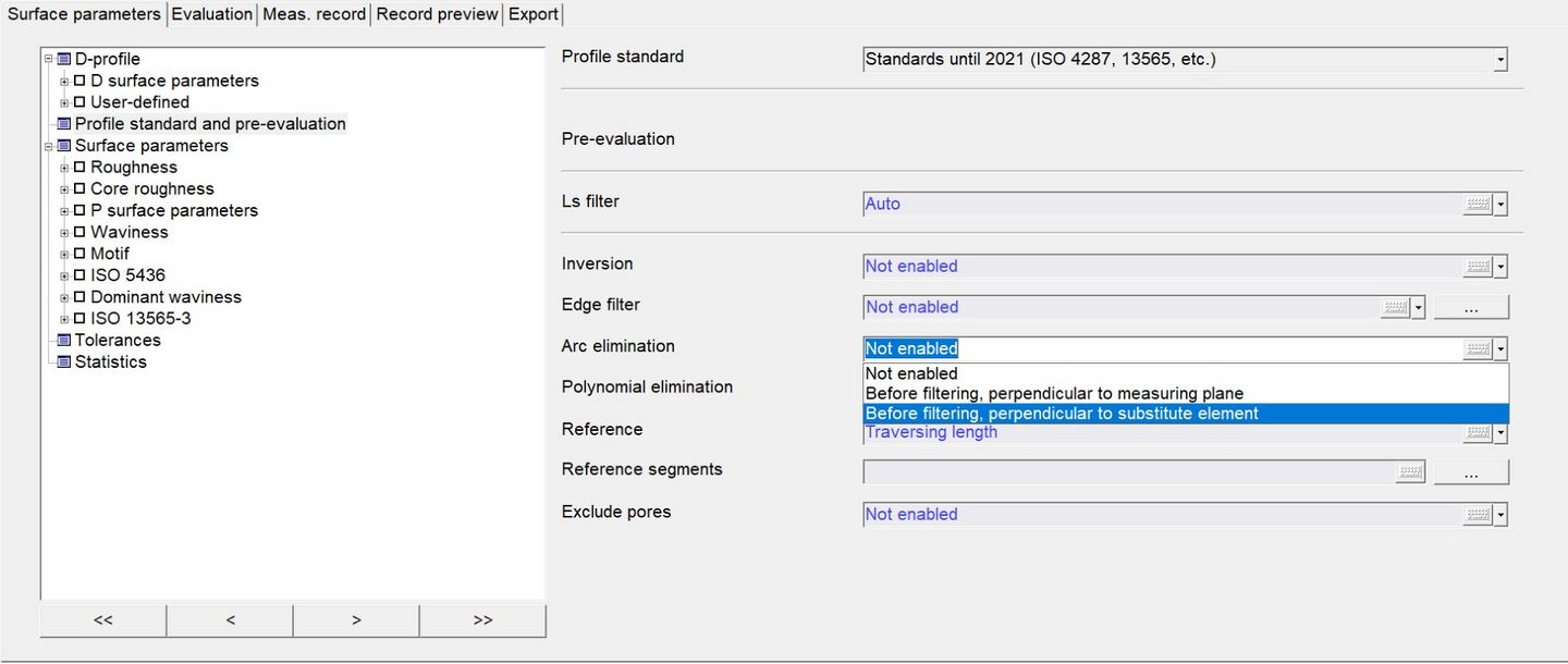

"Arc" selection box
From software version v14.50-03, Mahr now offers even more options for eliminating arcs.With the "Arc" option, you first select in the selection box that the arc elimination is to be carried out. The following options are available:
- not active (default setting) → no arc elimination
- before filtering, perpendicular to measuring plane
- before filtering, perpendicular to susbtitute element
Important: This step is currently not standardized. However, Mahr offers the following two options to make it easier to compare measurement results:
▶ Selection "Before filtering, perpendicular to measuring plane"
This option calculates the values in the direction of probing, i.e. perpendicular to the measuring path, back to the replacement elements. Consequently, the correction is made in the Z direction. This is the setting recommended by Mahr if the angular segment of the arc over which the measurement is made is not too large, as otherwise deviations may occur on the steep slopes.
▶ Selection "Before filtering, perpendicular to substitute element"
This option recalculates the values perpendicular to the substitute element, i.e. the arc. It is recommended for slopes > 66°, i.e. over large angular segments of an arc.
