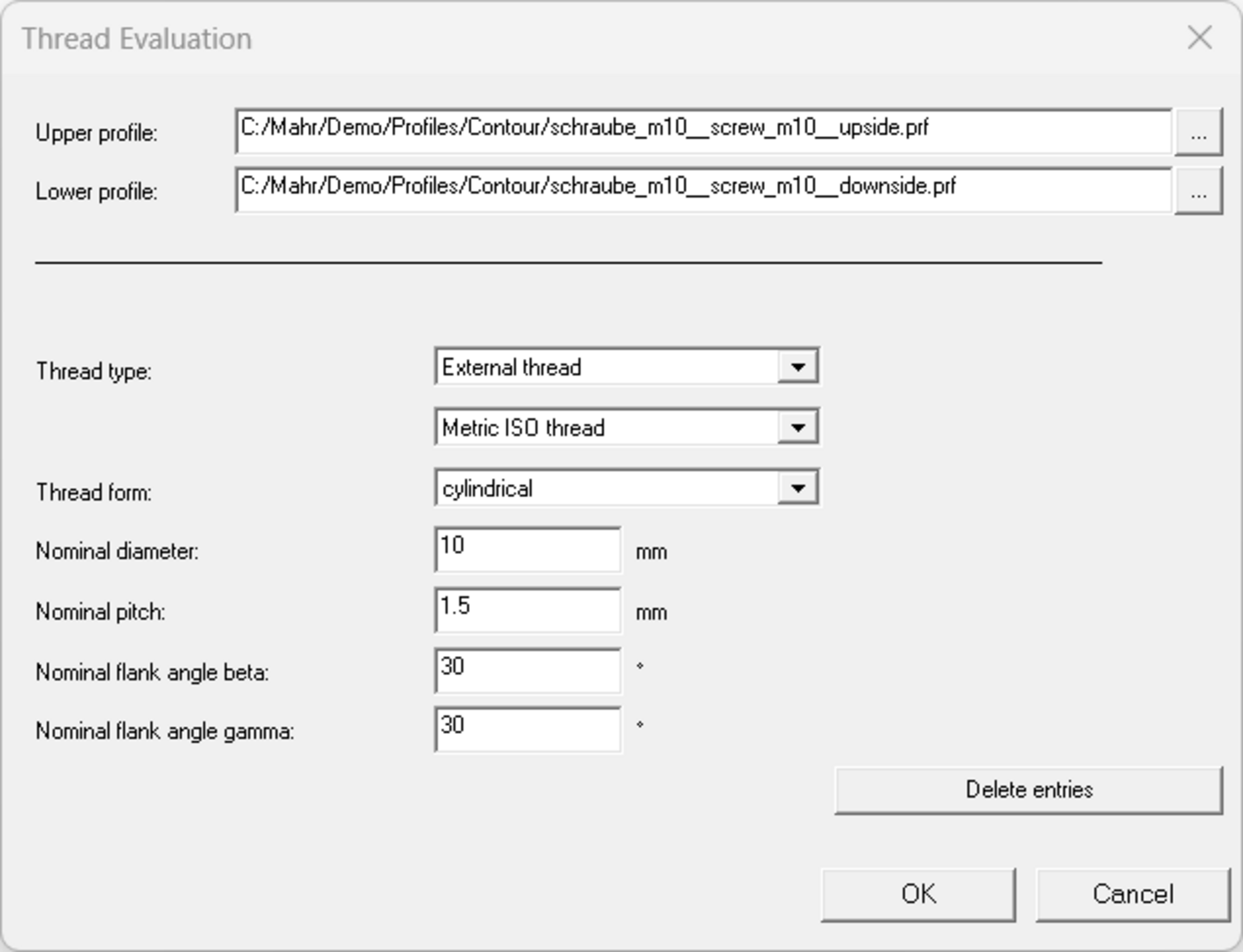

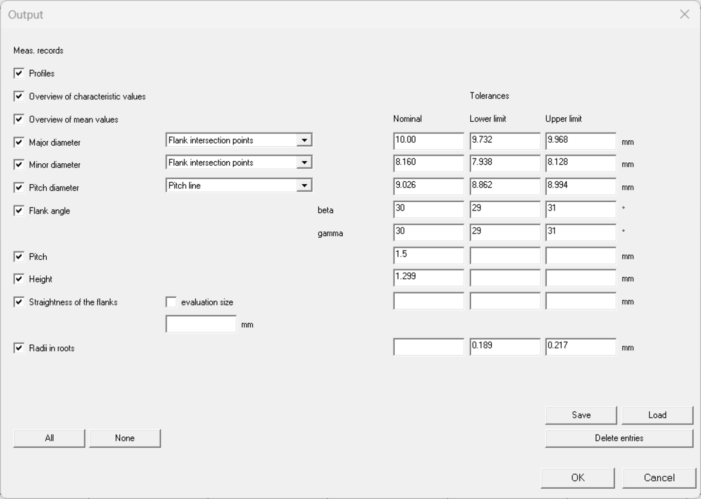

Thread evaluation parameters
 The measured thread profiles can be evaluated using the defined parameters, tolerances and measuring methods. The entries are logged and saved. This means they are available at any time for recurring measurements.
Fully automatic thread analysis
 The thread analysis is started after the profile has been recorded using a Quick&Easy measuring program. All you need to do is press the corresponding function key or a script after the measurement. All selected parameters are then evaluated for the defined thread range.
 The area to be analyzed can be defined simply by clicking on the first and last thread flank. For individually designed thread forms, it is possible to adjust the flank areas as required. This method offers a flexible way to define the thread area precisely and quickly.
Logging the thread evaluation
 After entering the data or loading the appropriate parameter files into the program, the thread appears in the profile on the screen. Two clicks with the mouse are then sufficient for the thread area to be evaluated and all selected thread parameters in this area are automatically analyzed. Based on the selected settings, the system automatically creates report pages with individual and statistical results. Deviations from the tolerances are highlighted in red.
