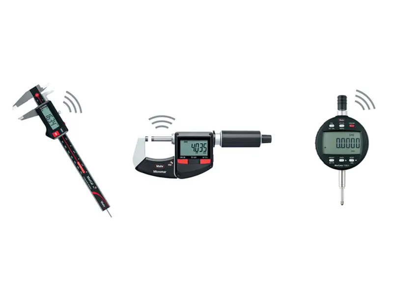

Now you're ready to think about the data collection part. What you're basically looking at is taking a few simple measurements, averaging them, and then recording the results. While this can seem simple, it is often the most daunting part of the process for the operator. Manual recording takes much effort on the part of the machinist or inspector, and is fraught with the potential for errors, like writing down the wrong number. Simpler, faster and way more accurate is to transmit measurement data electronically. Today's digital micrometers, calipers and indicators can transfer their measurement results wirelessly to the PCs already located at the workstation. Thus, there is no high cost barrier to begin the process of collecting data. With today's wireless gaging you can get going for the price of the gage.
The final step in setting up is to benchmark your machining process. You need to find out, simply, if your machine is capable of holding the tolerances or control limits you require. Your SPC guide can help you do this.
Now you're ready to gather data. Simply start feeding the data into the existing computer the operator is already using. Most everyone today is familiar with Excel® worksheets. Using wireless gaging it's easy to drop measurement data right into the spreadsheet. With this simple automation the operator is not being asked to do any more work. They still measure the parts -- only now they can watch their work being collected in the spreadsheet.
