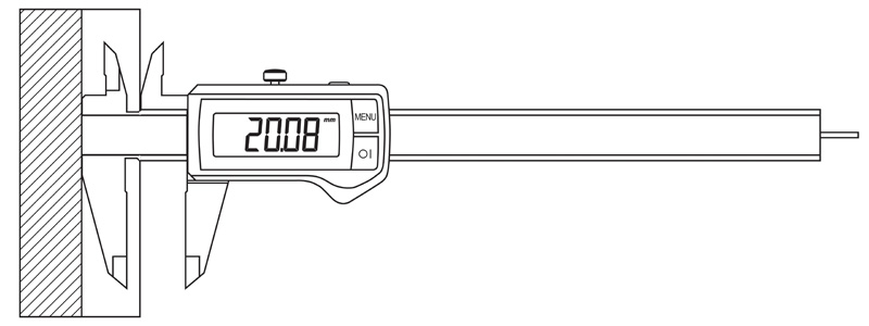

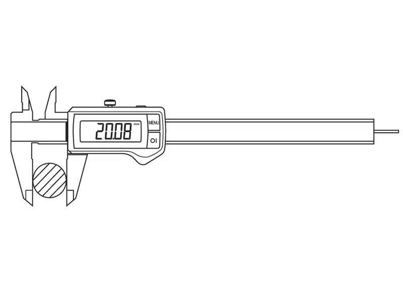

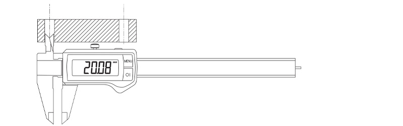

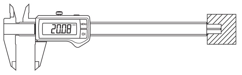

As shown in figures 1–4, almost everyone who has ever used a caliper is familiar with the four basic checks that the gage is designed to do: outside, inside, depth and step.

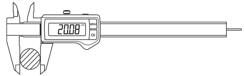

However, digital calipers also have the capability to make compound measurements. Since an electronic digital caliper can be zeroed at any point, you can use it to do some of the arithmetic required for calculating the results of a measurement. For example, the following procedure can be used to measure the center distance between two bores of equal diameter:
1) Use the inside jaws to measure the diameter of one of the bores (figure 5). Before you remove the caliper from the bore, press the button to zero the caliper while it is set to the diameter of the hole.

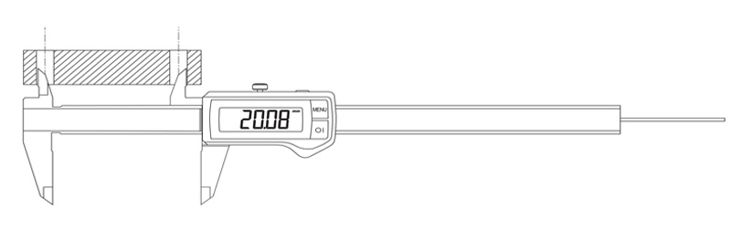

2) Still using the inside jaws, measure the distance between the far surfaces of the two bores (figure 6). The caliper reading will be the distance between the centers of the two bores.

Figure 1. Outside Diameter
Figure 2. Inside Diameter
Figure 3. Step
Figure 4. Depth
Figure 5
Figure 6
