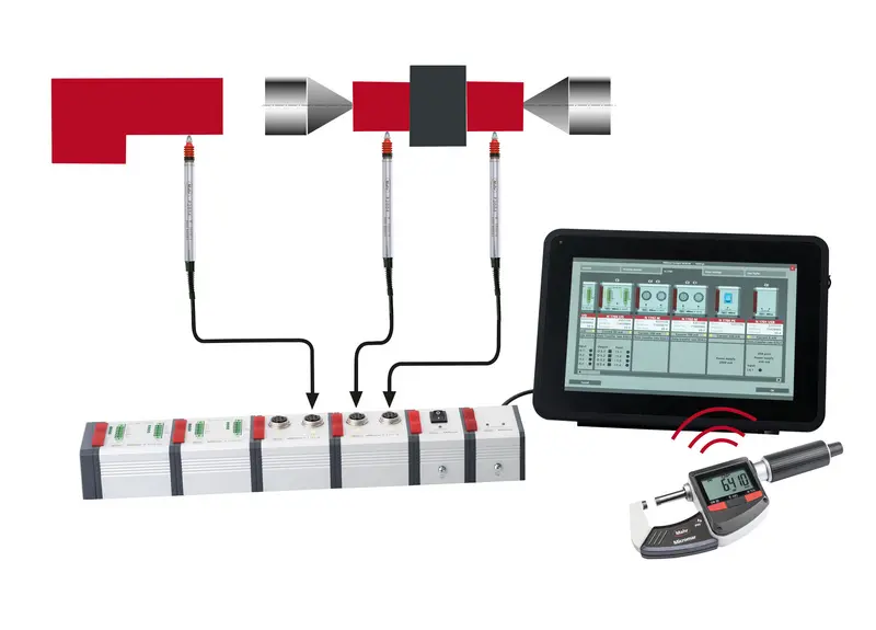

A better approach is to measure the temperature of the part, master, and workpiece and compensate for thermal variation based on the known coefficients of expansion.
With today’s user-programmable gaging software and the availability of small thermal sensors that are easy to interface with, it is simpler to combine these components and do temperature compensation right at the point of inspection.
The system can be programmed for different coefficients of expansion of the various components, and the results are fed into an algorithm that generates a temperature-compensated measurement result on the gage readout. (Additional compensation factors may be built into the algorithm to correct for unusual elements in gage geometry, differences between a workpiece's surface and interior temperatures, and similar variables.)  Such a system will typically reduce thermally induced errors by 90-95 percent, a figure most shops can live with.
Many software based measuring systems allow for configuration of the measuring task along with the ability to input measurement temperature data from the gage and the part for compensation of part size to a standard temperature.
