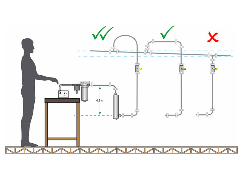

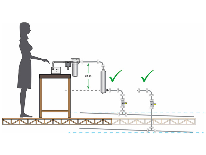

Air main lines should be pitched down from the source, with a proper trap installed on the end.  Feed lines should also be equipped with traps.  Take air from the top rather than the bottom of the mains, so that moisture doesn’t drain into the feed.  Long, gentle bends on feeds are preferable to hard angles and close ells.  Bleed air lines before connecting gages to them.  Gages must always have a filter in place when operating, and this should be changed when they become saturated.

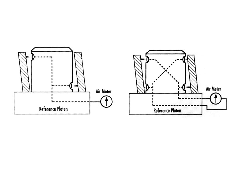

Because of the relative simplicity of fixture design, air gaging is especially suited to relational, as opposed to dimensional, measurements, such as squareness (see illustration), taper, twist, parallelism, and concentricity.

Two methods for gaging squareness: (Left) Use a two-jet plug with a standard air meter, rotate the part 180°, and monitor the total indicator reading. (Right) Use a four-jet plug with opposing circuits on the meter to isolate squareness and ignore any out-of-round condition.
