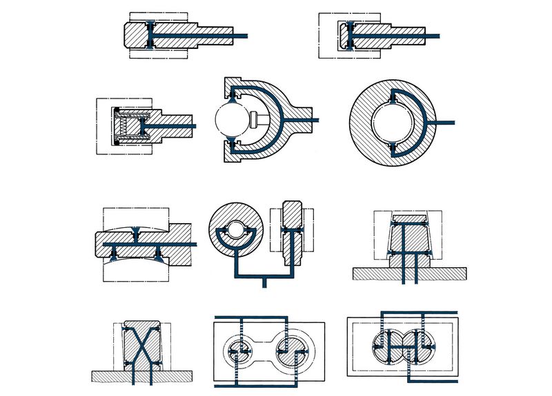

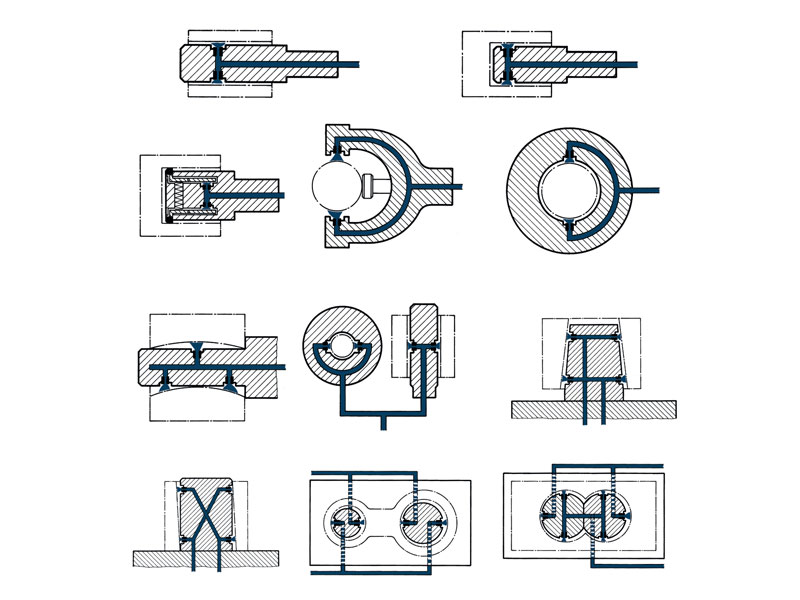

There are available several different measuring systems that can provide differential gaging, including air and electronic gaging. Air gaging is probably the most common, since every two-jet air plug and air ring utilizes the differential gaging principle. Most air gages measure back-pressure that builds up in the system when the tooling is placed near a workpiece: this results in higher air pressure, which the gage comparator converts into a dimensional value. Thus, as the plug fits into the part, it is the combination of both jets that represents the diameter of the part—without regard to where in the part the plug happens to be.
The same is true with electronic probes. In this case though, the probes are combined electronically to provide the differential measurement. Differential gaging using both air and electronic probes is used in a wide variety of applications that include measurement of form on angles and tapers and shafts without regard to the part dimensions. Also, concentricity of two shaft diameters; comparing a workpiece to a master; match gaging; and finally, checking parallelism of a workpiece and its support surface are all applications of this technique.
