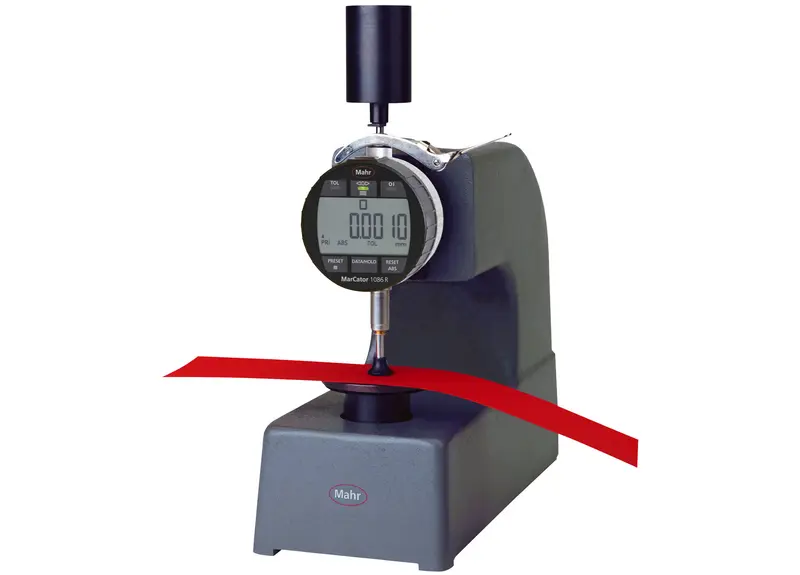

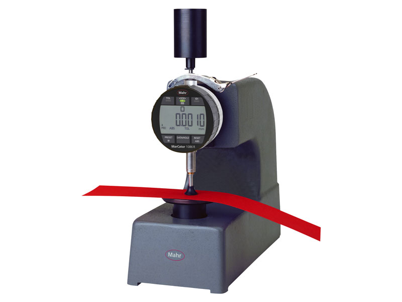

Thickness Gage.  The portable thickness gage raises the ante on resolution by combining a flat anvil-type reference surface on the bottom with a radiused (ball) measurement contact on top.  Making a single point measurement eliminates the possibility of gage error that could be caused by faulty parallelism of the contacts.  This would be a good gage for a narrow strip of photographic film where a spot check of thickness is required.

Custom Thickness Gage.  Many soft, compressible parts have rigid, standardized specifications for how they are to be measured.  In such cases the design of custom gages will frequently take into consideration the size and shape of the contact along with the gaging pressure applied to the part.  Usually, the gaging pressure is defined as a dead load weight to assure constant force over the full range of measurement.  However, with some compressible materials, such as paper or latex rubber, the amount of time that the load is applied to the part will also affect the reading from the gage.  In these cases, the gage may incorporate a motorized measuring contact along with the cam actuated device to retract the contact after a specific period of time.  This uniform load and dwell measurement prevents the parts from deforming and setting.
