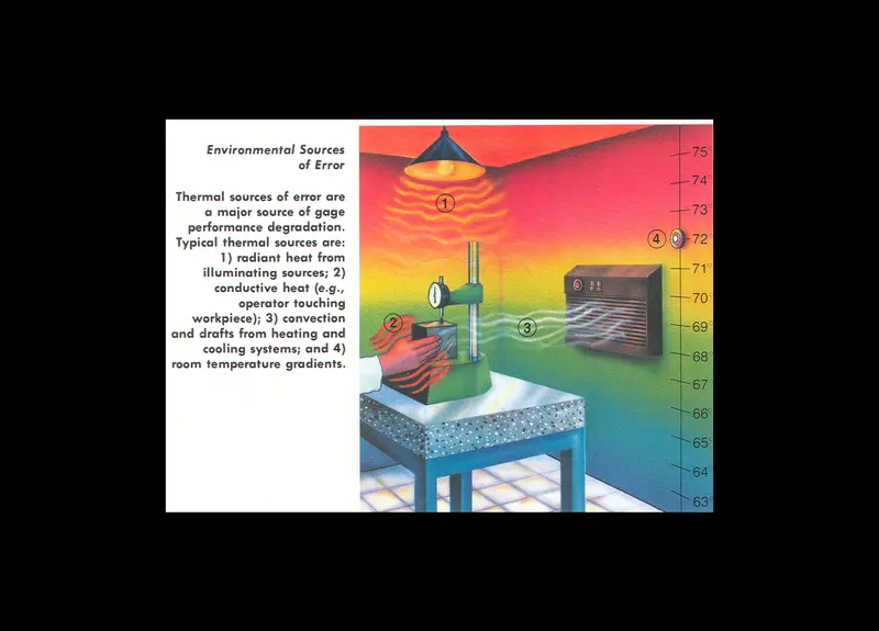

Temperature | Everyone agrees that a workpiece is bigger when it's hot. Any action taken to alleviate this usually involves cooling the part too much at the nearest drinking fountain. There should be a big flashing sign in every precision gaging area that reads: "Keep the temperatures of the workpiece, gage and master the same." There is also a tendency to put measurement equipment in locations that cripple their effectiveness. Some favorite spots include next to radiators, in the direct rays of the afternoon sun or near a door that's opened and shut 50 times on subzero days.
