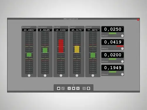

Nächster SpotClear visualization for production

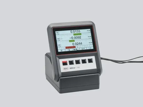

Millimar C 1202
With the Millimar C 1202, you get the next generation of multi-channel compact devices for length metrology – ideal for your measurement tasks with manageable complexity. Thanks to its sophisticated features such as the tiltable, readable display, the clear menu navigation and the flexible display of measured values, it offers maximum ergonomics and user-friendliness.

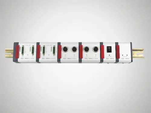

Exchangeable modules
In combination with one of the easy-to-change modules of the N 1700 series, you get the measuring instrument perfectly suited to your measuring task. You can use it to solve a wide range of measuring tasks, e.g. static and dynamic measurements, but also cone calculations. Depending on the module, you can also use existing probes from other manufacturers, which reduces your costs.
Flexible and productive
The sophisticated equipment of the
Millimar C 1202 ensures safety and precision:
N 1700 modular system for maximum flexibility
Programmable measuring sequences for more productivity
Perfect visualization: three features can be displayed simultaneously
Display can be optimally read from all viewing angles
Static or dynamic measuring tasks
USB and Digimatic interfaces for easy connection

The N 1700 modules are designed as a bus system for convenient and safe evaluation of your measurement sensors. They can be expanded as required, are independent in their sequence and are slim and compact. This means you can always put together the right solution for your individual measurement task.

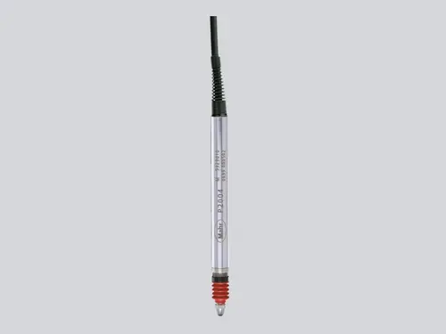

Probes and sensors arethe most influential components of a measurement chain. Their properties determine the quality of the entire measurement. The measuring sensors of the Millimar portfolio differ depending on the measuring task in order to provide an exact result at any time.
