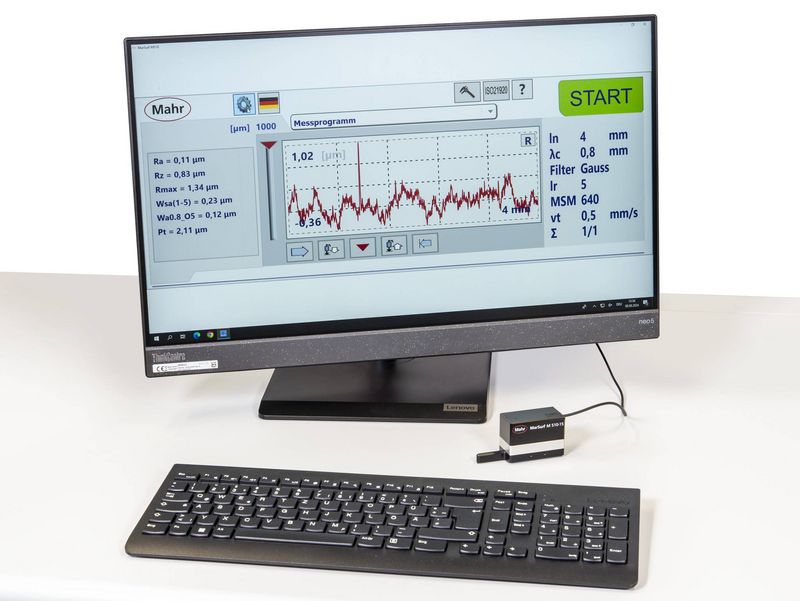

Smallest skidless system with 15 mm measuring range
Surface evaluations using skidless tracing are needed not only in the measuring room but more and more in the production area.
Compact design
- Smallest free probe system on the market
- Handy and convenient thanks to its small size and weight
- 3 different versions in measuring lengths of 15 mm, 50 mm and 75 mm
- Vibration-resistant - can be used in production and processing machines
Unique
- Unique device for the sheet metal industry with free scanning system in accordance with SEP 1941 (measurement of the waviness characteristic value WSA(1-5) on cold-rolled flat products)
- Motorized probe pin lifting/lowering – The probe pin is the only wearing part and is always protected in the housing.
- Easy-to-use software
- Easy installation and set-up by the customer
Standard-compliant measurement
- Standard-compliant determination of roughness parameters and application of filters
- Mobile and convenient testing of P, R and W parameters with just one device
- Measurement in accordance with new standard DIN EN ISO 21920-2 : 2021
- Measuring distances up to 75 mm for waviness and large roughness
MarSurf M 510 MiniProfiler | № детали 6910310 | |
Конец длины трассирования (по оси X) | 15 mm |
Длина трассирования (Lt) | till 15 mm |
Measuring principle | tactile stylus method , tactile skidless probe |
Измерительное усилие (Н) | 0.00075 N |
Probe tip radius | 2 µm |
Фильтр в соответствии с ISO/JIS | DIN EN ISO 16610-21 (Gaussian filter), DIN EN ISO 13565 Part 1 (specific filters), DIN EN ISO 16610-31 (robust Gaussian filter) |
Отсечка шага Ic в соответствии с ISO/JIS | 0,08 mm , 0,25 мм , 0,8 мм , 2,5 мм , 8,0 mm , переменное |
Число n базовых длин в соответствии с ISO/JIS | 5 |
Скорость измерения | 0.1 mm/s to 2 mm/s |
Скорость позиционирования (мм/с), ось X | till 2 mm/s |
Параметры поверхности |
Over 75 characteristic values for R-, P-, W-profile |
Интерфейс передачи данных | USB A , 4x USB 3.1 Gen. 2 , Порт для подключения дисплея , HDMI , wireless |
Щуп | inductive skiddless probe system |
Температура эксплуатации | 5 °C to 35 °C |
Масса блока привода | 150 g |
Габариты (Д x Ш x В) блока привода в мм | 52 x 28 x 40 |
Прочее | other standards: Daimler MBN 31007, SEP 1941 |
Наконечник щупа | 2 µm |
Диапазон измерения в мм | 1 mm |
