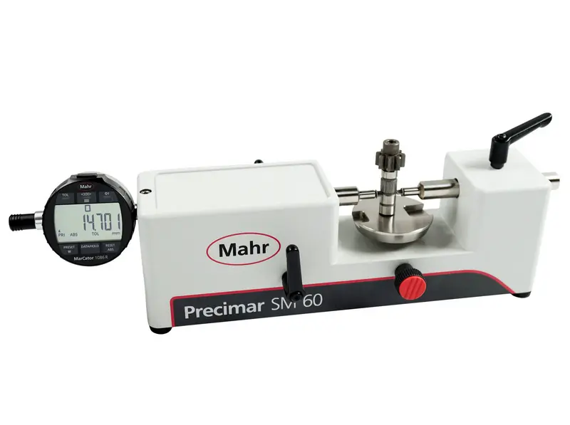

Precimar SM 60-V
Art. no. 5357380
Length measuring bench for outer measurements with 60 mm application range
| Precimar SM 60-V | Malzeme no. 5357380 | |
| Uygulama aralığı mm | 0 - 60 |
| Ölçüm kuvvetleri [N] | 5 N + measuring force of the measuring system |
| Cihaz boyutları | 290 x 140 x 120 |
- For rapid measurements of cylindrical parts (shafts, bolts and shanks)
- Thickness and length measurements
- Ideal adaptation to the measuring contour through individual use/combination of measuring inserts (flat, spherical, pointed, etc.)
- For determining the pitch diameter of external threads (optionally with thread flank measuring anvils)
- For gears (optionally with sphere or roller measuring anvils)
- Particularly suited for exact series measurements
