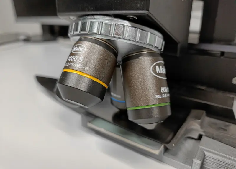

In order to generate surface data, metrology specialist Mahr came into play. Mahr's GAM 3D Surface business unit in Oberhausen provided the researchers with a MarSurf CM mobile for two weeks to measure the surfaces of the knives for roughness using 3D scan.
The optical measurement system of Mahr's MarSurf CM mobile is based on confocal technology, and its typical measurement time is between five and ten seconds. The 3D measuring device can be used to perform ISO-compliant roughness measurements, analysis of 3D structures and measurement of geometries. The evaluation of structuring and volume parameters is automatic.
