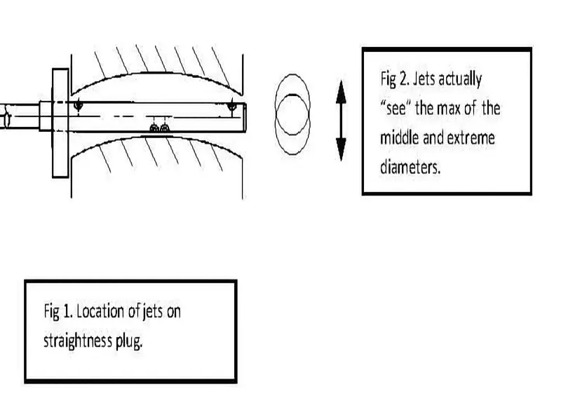

A typical air plug has four measuring jets in two opposing sets—two near the middle and two near the ends, as seen in Figure 1. This design allows the plug to look at both extremes of the bow condition.
There are no rules for the exact positioning of the jets relative to each other—as is sometimes the case with taper or squareness checks. Nor are there any ratios involved. The air jets at the extreme of the plug are positioned to inspect for the out-of-straightness condition which is usually specified over the total length of the bore. But, in order to understand how a straightness plug works, we have to take a quick look at the various combinations of jets typical in air tooling.

The four jets are normally at the same level or plane on the plug. In theory, the four jets could be moved anywhere along the length of the plug independently, and if they are positioned at 90 degrees to each other, they will measure an average diameter of the bore. But if we move the jets so that two are on the same side at the extremes of the plug, and the other two are moved to the center on the other side of the plug, we have the straightness plug described above. If the part being measured is perfectly straight, and the plug is moved up and down, it acts like a two-jet piece of tooling. The two jets on the top are offset by the two jets on the bottom, and the result is no change on the display. But if the bore is not perfectly straight, the combined pressure changes, and the differential is shown on the instrument.

Again, looking at Fig. 1, we can understand what the inner and outer jets are looking at. When the jets are in line with the bow (jets up and down), the jets are seeing either their max or min reading depending on the orientation. When moved 180 degrees, the inner and outer jets reverse roles and the same value is seen, and the plug is working in its differential mode.
But as the plug is rotated through 180 degrees exploring the bore, the pairs of jets will experience a maximum clearance and then find the minimum clearance, usually at right angles to each other. This difference between the maximum and minimum value is the out-of-straightness condition as seen over the total length of the plug measurement length.
You can also think of it this way: If you looked at the bore from the end, and drew a line around the extremes of its path, you would end up with an ellipse (Fig. 2). If you had an ellipse in a hole, a two-jet air plug would be capable of measuring the variation in size by rotating it in the part. Think of the straightness plug as a stretched out air plug with four jets doing the same thing. With this in mind, you have a pretty good understanding of what the straightness plug is doing.
