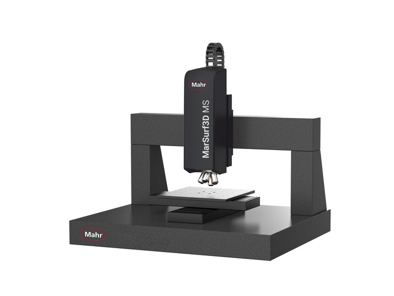

Cleverly combined: Use the new MarSurf3D GS platform with the new multi-sensor measuring head, which combines area-based measuring technologies. This means you can perform all surface measurements down to the lower nanometer range with a single device. The GS platform offers you maximum flexibility for large workpieces, additional point sensors and 24/7 performance.
Maximum flexibility is achieved by combining the individual technologies: Confocal, white light interferometry and focus variation. The different strengths of the technologies can be utilized in one measuring system.
Confocal
The specially developed and patented multi-pinhole technology ensures ultra-fast image capture with the highest signal quality, resulting in maximum repeatability down to the subnano-meter range. This technology is suitable for a wide range of applications in the field of surface metrology, from smooth to very rough surfaces.
Interferometry
Interferometry offers a vertical resolution in the subnanometer range, regardless of the magnification. This allows surface heights in the NM range to be recorded on large measuring fields. Interferometry comes into its own on very smooth and continuous surfaces and is also suitable for the ultra-precise determination of step heights.
Focus variation
Focus variation with active lighting is a technology developed for measuring the geometry of large rough surfaces. Steeply inclined surfaces (up to 86°) in particular and a large vertical measuring range can be recorded in one measurement.
- Roughness measurements as per
ISO 21920 / 4287 & ISO 13565 / ISO 25178 - Topography measurements (including volume, wear, tribology)
- contour and form (2D, 3D)
- pore, particle analysis
- defect detection
Your measuring data is recorded reliably, can be replicated, and guarantees the highest quality of raw data and profile accuracy.
High resolution measurements of large surfaces in the shortest time guarantee maximum cost-effectiveness without compromising on quality.
Complete freedom of portal design and flexible component selection from a module building set.
