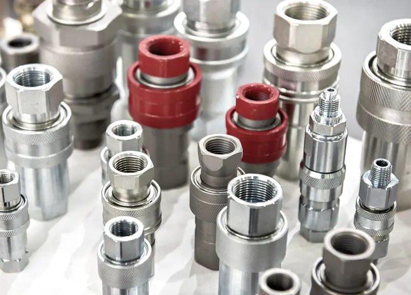

The portfolio of the customer from Baden-Württemberg includes quick-connect couplings for low, medium and high-pressure applications. The components are made of brass, stainless steel, steel or plastic, are manufactured in countless variants and are used in aerospace, on the high seas, underwater, in road traffic or in classic manufacturing operations. The couplings are assembled from several individual components and cut to size according to customer requirements. Bores are then required at various points – for example, to make cleaning connections for endoscopes or breathing air technology. These are extremely small holes between three and five millimeters. The tolerances are minimal; each part must fit perfectly. For this reason, the quality technicians always measure the inner contours of the narrow seal recesses as well as their position, width and inner diameter with great precision. In addition to various valve designs – free passage, one-sided and two-sided shut-off, and low-leakage – the manufacturer also offers accessories such as fittings, hoses, or blow-out guns for the couplings.
