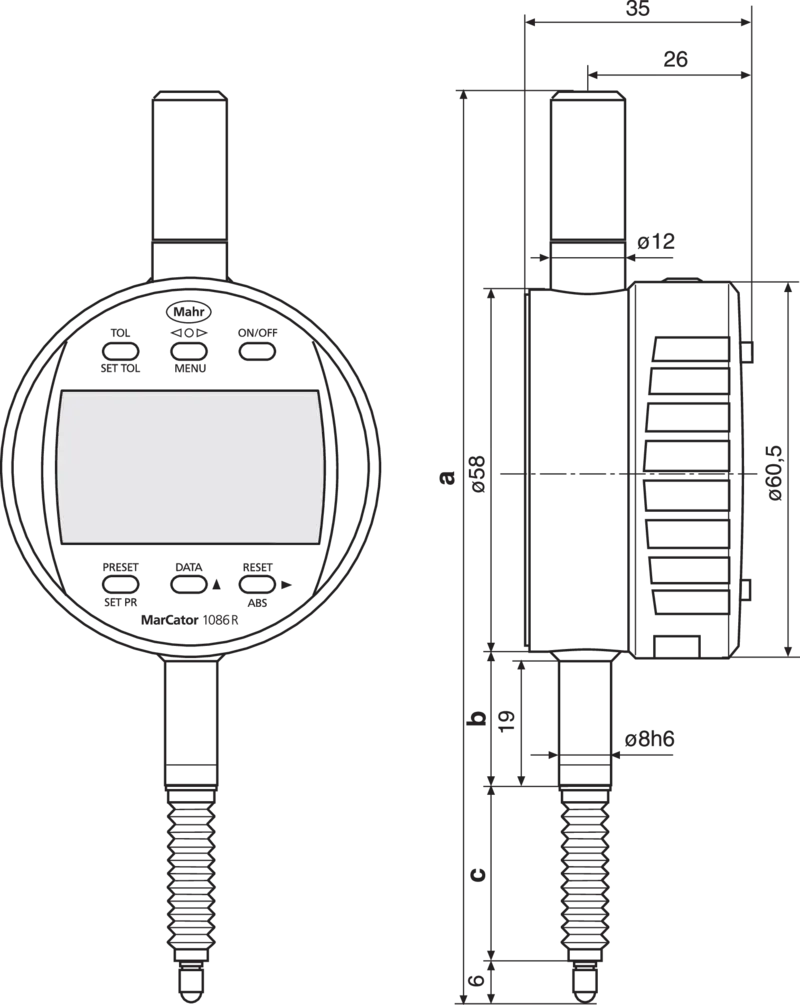

MarCator 1086 WRi
Art. no. 4337143
Digital indicator MarCator 1086 WRi
IP protection category: IP 54
Data interface: Integrated Wireless, Digimatic, Opto RS-232C, USB
Factory standard
Measuring span in mm: 25mm
| Product type | 1086 WRi |
| Measuring span in mm | 25 mm |
| Measuring span (inches) | 1" |
| Resolution | 0.0005 mm , 0.001 mm , 0.002 mm , 0.005 mm , 0.01 mm |
| Error limit (mm) | 0.004 mm |
| Repeatability mm | 0.001 mm |
| Measuring force (N) | 1 - 2.25 |
| Height of digits | 11 mm |
| Battery type | CR 2450N (3V Lithium) |
| Dimensions | a 193.2 mm | b 24.8 mm | c 50 mm | |
| Label | Art. no. | |
