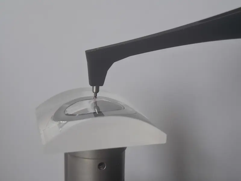

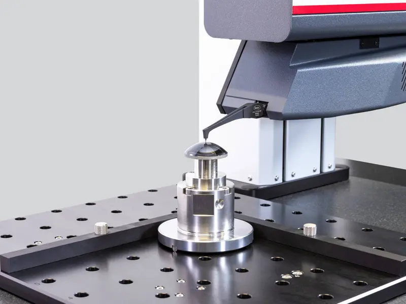

Flexibel, fast and highly precise – the new MarOpto LD 280 Aspheric
The MarOpto LD 280 Aspheric 2D system cost-effectively integrates measurement technology into production via closed loop. The increased measuring x-axis distance of 280 mm and the large measuring range of up to 37.5mm (probe arm stroke), makes measurement of even larger spheres, aspheres, and DOEs possible – with the proven accuracy and speed. Mahr’s innovative technology for the magnetic attachment of the probe arms ensures perfect positioning and automatic detection, making exchange child’s play. The optimized interface integrates the chip-coded probe arms reproducibly into the measuring circuit, reducing the need for calibration. As the scanning force can be adjusted electronically, even the most sensitive materials are safe.
- Process-optimized software for the best integration into the manufacturing process (Closed Loop) of precision optics
- Evaluation according to ISO 10110-5, including astigmatism and additional Zernike coefficients
- Improved and extended export functions for the Closed Loop
- Optimized measurement and evaluation of diffractive optical elements (DOEs)
- Double-sided measurement for the determination of the inner centration of optical elements, according to ISO 10110-6
- The industry standard HD 25 serves as the interface to the workpiece

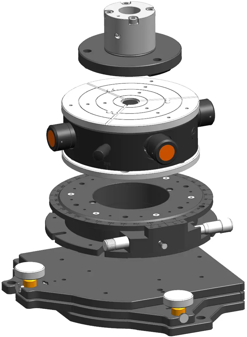

- Optional: The manual rotary device allows for one or more linear cuts to be measured, enabling the evaluation of astigmatism
- Optional: Using a tilt and centering table, loose lenses can be aligned before measurement
- Newly developed, highly efficient probing system with a measuring range of up to 37.5 mm
- Easy probe arm change via magnetic interface with chip recognition and electronically adjustable probing force
