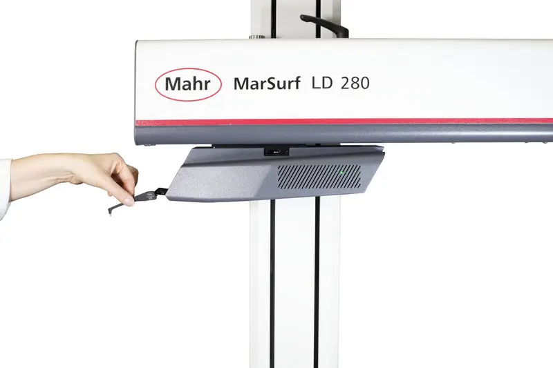

MarSurf LD 280
제품번호 6269042
Highest precision with
simultaneous roughness
and contour measurement with
280 mm tracing length.

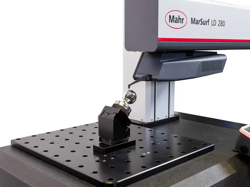

The new MarSurf family CD, GD, VD and LD offers precision products with maximum speed and flexibility.
A better floor-to-floor time of up to 65% is convincing proof of the speed. The flexibility is demonstrated by the large measuring range, the workpiece flexibility (even up to 80 kg) and the simple clamping system. The latter again supports repeatability and therefore accuracy.
The special feature of the MarSurf LD is that the probe arm unit simultaneously records roughness and contour data, which can be evaluated in one go to save time.
Efficiency and precision combined
Measure roughness and contour at the same time and with maximum accuracy with the new LD 140/280:- Newly developed, highly efficient touch system
- Single acquisition of roughness and contour measurement data and simultaneous evaluation
- Easy probe arm change via magnetic interface with chip recognition and automatic tactile force selection
- Enormous time and cost savings compared to conventional measuring devices.
- X-axis optionally with 140 or 280 mm; Z-axis optionally with 350 or 600 mm available (always CNC).
- TY table axis optionally motorized or manually adjustable.
- Use of the current MarSurf platform control and thus long-term service and spare parts supply.
- The simple clamping system positions workpieces safely, quickly and correctly.
- The measurement itself is up to 65 % faster thanks to the fast axes and the new probe system (measured using the example of a journal).
- The entire process can be automated, thanks to CNC axes and the MarWin measurement and evaluation software. This enables further savings in the process on site.

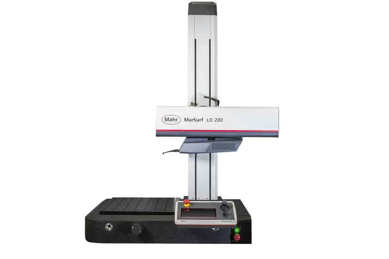

| MarSurf LD 280 | 품목 번호 6269042 | |
| 측정 길이 시작 (X) | 0.1 mm |
| 측정 길이(Lt) | 0.01 - 280 mm |
| 측정력(N) | .7 mN to 30 mN, adjustable via soft |
| 측정 속도 | 0.02 mm/s - 10 mm/s |
| 위치 이동 속도(mm/s), X축 | 0.02 - 200 mm/s |
| Positioning speed Z-axis | 0.02 - 50 mm/s |
| 프로브 | Combined roughness and contour probe system |
| 프로브 암 길이 | max. 250 mm |
| 작동 온도 | 15 °C - 45 °C |
| Lagertemperatur | -15 °C - 50 °C |
| 측정물 무게(최대) (kg) | 90 kg |
| 기타 | manual TY |
