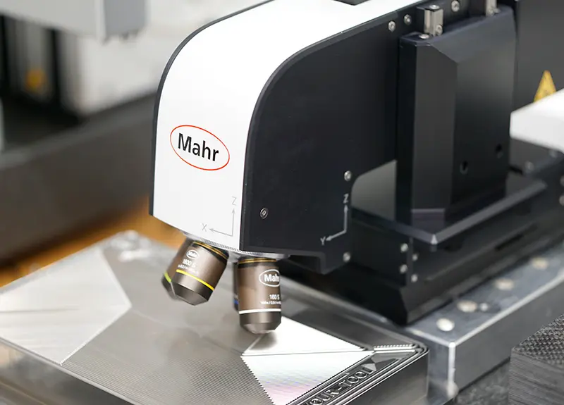

To check the surface quality of the milled tool in the nanometer range, YOUR-TOOL also has a MarSurf CM mobile in the measuring room. The optical measuring system is based on robust confocal technology. The typical measurement time for a single field of 800 x 800 µm is five to ten seconds. The measurements are fast, contactless and independent of the material. With its motorized axes, the MarSurf CM mobile offers the possibility of stitching larger measuring fields at a consistently high resolution. With an objective nosepiece, a color camera and a variety of software solutions, the measuring system easily meets the requirements of measuring tasks on bipolar plates. "With the CM mobile, DIN EN ISO-compliant roughness measurements, analyses of 3D structures and the measurement of geometries can be carried out. The evaluation of structuring and volume parameters is performed automatically," explains sales engineer Maksuti. The measurement results are transferred to a freely definable measurement protocol.
