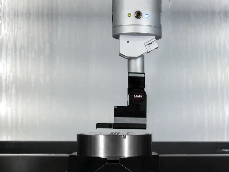

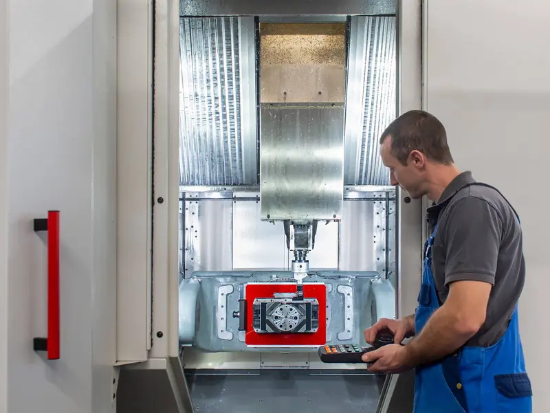

Roughness measurement directly in the processing machine- Automated measuring sequence for measuring the surface characteristics in accordance with the standard
- Exactly reproducible measurements without operator influence
- Increased process reliability by eliminating manual and downstream checks
- Integrated calibration standard for calibration in the program sequence
- Automated roughness measurement without manual intervention by the operator – 100% inspection
- Flexible machining processes thanks to direct control and measurement data output in NC code
- OPC UA interface and closed-loop-ready
- Direct clamping of the MarSurf MC 510 in the tool change magazine
- For all standard tool holders (HSK A63, HSK A100, SK40, BT40, Capto 6, etc.)
- Wireless connection between roughness measuring device and processing machine
