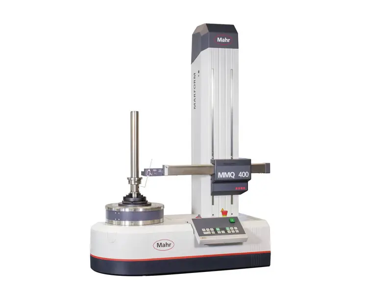

MarForm MMQ 400-2
Art. no. 5440781
Z=500/X=280: Fully automatic, highly accurate form and position measuring device with large measuring volume
The MarForm MMQ 400-2 series is the flexible, optionally semi-automatic or fully automatic solution for form and position measurement and more.
The use of axes with high running smoothness in combination with the MarWin platform software enables extended applications such as roughness, waviness and contour measurements.
The flexibility and universality result in a highly economical measuring system that pays for itself in a very short time.
- Measurement of high-precision workpieces
- Measurement of unusually long workpieces
- Measurement of large and/or heavy workpieces
- Use in production or inspection rooms
- Fully or semi-automatic centering and tilting table
- Verticale Z axis with 350, 500 or 900 mm measuring length
- Horizontal X axis with 180 or 280 mm measuring length
- Motorized probe system T7W with rotation axis or flexible probe system T20W available
- 900 mm optional motorized tailstock for shafts from 200 mm long
| MarForm MMQ 400-2 | Art. no. 5440781 | |
| Pos.-/Meas. path X-axis | 280 mm |
| Pos.-/Meas. path Z-axis | 500 mm |
| Positioning speed C-axis | 0.2 - 20 1/min |
| Positioning speed X axis | 0.5 - 30 mm/s |
| Positioning speed Z-axis | 0.5 - 100 mm/s |
| Workpiece diameter max. | 530 mm |
| Straightness deviation X-axis | 0.5 µm/100 mm |
| Straightness deviation Z-axis | 0.15 µm/100 mm |
| Reference temperature | 20 °C |
| Centering and tilting table | motorized |
| Table diameter | 285 mm |
| Table load max. | 60 kg |
| Probe system | Tactile 1D |
| Special equipment | CNC table |
| Permissible humidity | max. 85 % relative humidity; non-condensing |
| Weight basic unit | 260 kg |
