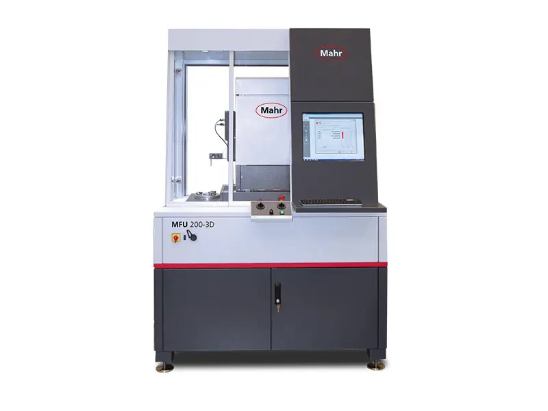

MarOpto MFU 200-3D
Art. no. 5440581
The close-to-production 3D measuring station - ultraprecise and universal
The MarOpto MFU 200-3D is a universal machine for measuring contour, roughness, axis offset, radial runout and tilt errors in lenses in one setup. It is thus ideal for spheres, aspheres, cylinder lenses and freeforms. Measurements are taken automatically, quickly and close to production in 2D and 3D. Thanks to the unique combination of optical and tactile probe arms, a reference surface of the component can be used to determine the form and position of the other surfaces.
- Increased productivity thanks to minimal calibration
- Accuracy due to dynamic realtime compensation (measurement uncertainty < 100 nm [PV])
- Reference system on the component itself thanks to combination of optical and tactile sensors
- Flexibility thanks to measurable gradient angle of up to 45°
- Standard evaluation as per ISO 10110-5
- Universal thanks to automation of different measuring tasks on one machine
The MarOpto MFU 200-3D can perform optical and tactile measurements of surfaces in one setup. When the two measuring procedures are combined, the surfaces are referenced in a coordinate system, which is particularly relevant for cylinders and freeforms. The MarOpto MFU 200-3D has an automatic centering and tilting table, which both ensures high reproducibility and saves time.
