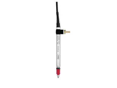

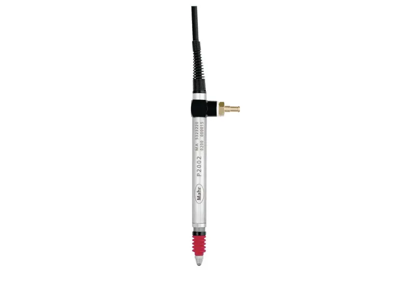

Millimar P2002 TA
Art. no. 5323221
Inductive probe Millimar P2002 TA
Compatibility: Tesa
Measuring range mm: ± 1 mm
Vacuum lifter
Measuring force (N): 0.75 N +/- 0.15 N
Package contains: test certificate, instruction manual, cap for radial cable output, spanner for preliminary stroke setting
- Variant with pneumatic lifter
- High linearity over the entire measuring range
- Excellent electromagnetic shielding (EMC)
- All probes can be easily converted from axial to radial by mounting a slip on cap, included in the scope of supply
Millimar P2002 TA | Art. no. 5323221 | |
Product type | P2002 TA |
