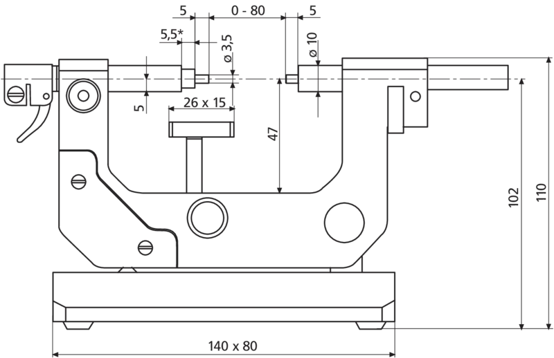

Marameter 852 TS
Art. no. 4510030
Indicating bench snap gage Marameter 852 TS
Measuring range mm: mm
Package contains: plan carbide anvils Dia. 3,5 mm
- Strong steel frame integrated in sturdy machine base, can be inclined 45°
- Stainless, hardened steel measuring and counter probes with Ø 3.5 mm mounting bores for interchangeable measuring anvils with a shaft length of 15.5 mm
- Height-adjustable workpiece stop
- Counter probe can be adjusted sensitively
- Constant measuring force with integrated measuring force spring
| Product type | 852 TS |
| Application range mm | 0 - 80 |
| Measuring span in mm | 1.2 mm |
| Flatness in µm | 0.3 µm |
| Parallel error in µm | 2 µm |
| Measuring force | 7.5 N |
| Mounting hole for indicator (mm) | 8 mm |
- Perfect ergonomic design as base can be inclined ensuring it is easy to read and the operator has free hands
- For rapid measurements of cylindrical parts (shafts, bolts and shanks)
- Thickness and length measurements
- For determining the pitch diameter of external threads (optionally with thread flank measuring anvils)
- For gears (optionally with sphere or roller measuring anvils)
- Particularly suited for exact series measurements
