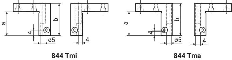

Multimar 844 Tmi
Art. no. 4503031
Mounting attachments 844 Tmi
- For outer (844 Tma) and inner diameters (844 Tmi) in standard assemblies. In reverse installations, the measurement type is reversed to extend the application area.
- Stainless steel
- Lateral mm scale for easy positioning and adjustment of measuring limit stops
- Reversible measuring arms on measuring arm holders to increase the measuring range
- With ø 5 mm holder for inserting interchangeable 844 Ta, 844 Ti, 844 Tb, 844 Tc, 844 Td, 844 Tz and 844 Tv measuring anvils
| Multimar 844 Tmi | Art. no. 4503031 | |
| Mounting hole | 5 mm |
| Dimensions | a 24 mm | b 32 mm | |
| Label | Art. no. | Adjustment range start in mm | Adjustment range end in mm | Adjustment range | Platelet diameter | Platelet length | |
